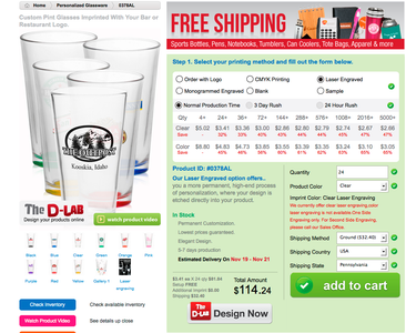

If you go to Discount Mugs.com and look at their mixing glasses: http://www.discountmugs.com/product/16-oz.-custom-pint-glasses/
You will see that it is $3.41 per glass when purchasing 24 mixing glasses $32.40 for Shipping. For a grand total of $114.24 Wowee That sucks!!!
So if we subtract $15 for the glasses from the $114.24 = $99.24 you could save doing it yourself.
Even if you bought the maximum amount from discount mugs 5000 (excluding a difference of $1,000 in shipping) they only get as low as $2.66 per glass. 24 X 2.66 = $63.84 $32.40 for shipping = $96.24 (- 15 for glasses) = $81.24 you could be saving by doing it yourself.
So once again how much is an hour of your time worth? $80 ? $90 ?, I know a monthly member ship at techshop is only $125, so do 48 Glasses and you've already saved that much.

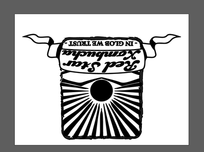

Next, Rotate baby rotate. We want our image to be displayed upside down. For two reasons. One the printer needs this to print correctly and two we are going to arc the top of the image in the next step.

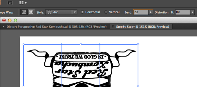

Step 2: Arc It
We are going to add a 2% arc to the top (bottom) of the image to compensate for the tapering of the glass.
To do this.
(For Earlier versions of illustrator, you choose Object > Warp > Arc)
Select your design, goto the pull down menu and choose: Object >Envelope Distort > Make with Warp
A box should pop up giving you parameters. Choose Preview to view the changes. The default is 50% which is way too much. Bring that down to 2%.
Hit Ok and you should have a slight expansion in your design.

To do this.
