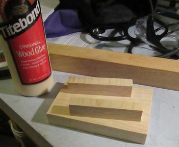

In this step, glue the other sides of the miter box to the foundation. Use other pieces of wood to align:

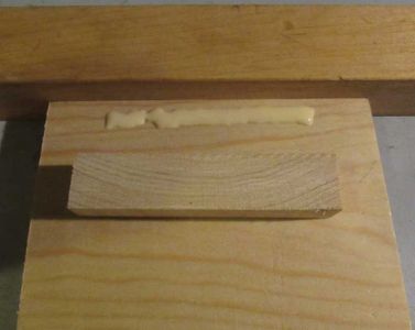

  • Glue one side, align to edge of the box's foundation.
  • Wipe excess glue.

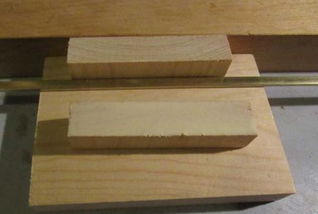

  • Place work piece (what you'll cut) into the miter box.
  • Glue down the other side of the miter box, with work piece in the middle.
  • Remove work piece.
  • Wipe excess glue.

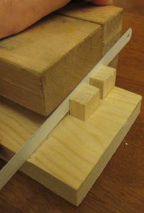

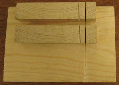

Use additional pieces of wood to align a saw blade to the miter box and make a groove for the blade.
