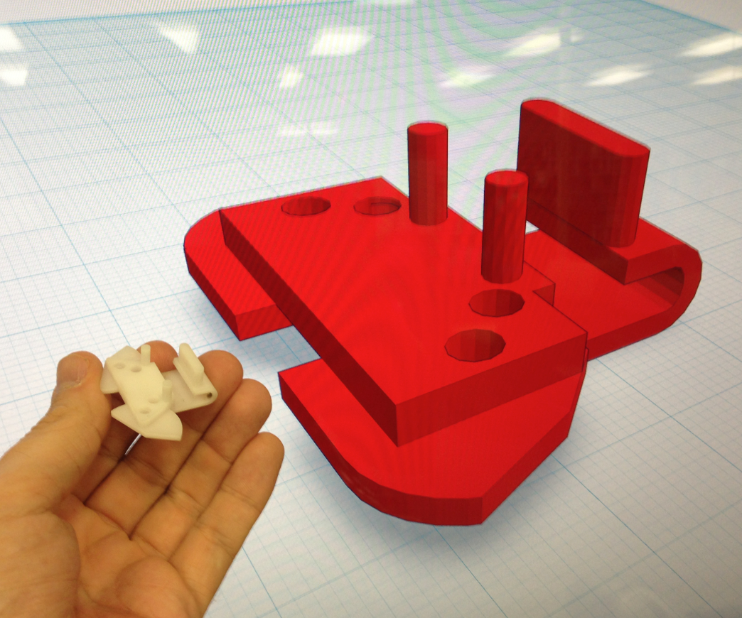

Step 2: Design in TinkerCad
Import the 3D scan into TinkerCad, a free online 3D Design Software.
www.tinkercad.com
If there is interest I can create a Instructable on how to use TinkerCad but their website has tutorials for new users. The software is very easy to learn and I volunteer at our Maker Space teaching, kids 5 years old up to retirees, how to 3D Design with this software.
The video at the end of this Instructable has a spoken tutorial on the process below:
- Use the software's blocks to build a case around the scan. I didn't take any measurements, and eyed the size and shape that looked and felt right for me.
- Use the hole tool on the scan to hollow out the case for an exact fit for the tool.
- I created a slot in the front so the tool can be easily removed with one finger.
- I wanted a maker theme so I used the software's text tools to add this. I turned the text on the sides to holes so the tool will show through.
- Use blocks and holes to create a loop for the belt to go through.
- I added holes in the back to tweak the design to how I waned it to look.
