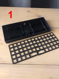

I created the case in CAD, I used standard keycap spacing to find the size of the inside cavity where the plate was held. The case was angled at 5˚ to put my hands in an ergonomic position whilst typing. I used ribs to increase the strength of the part since it had relatively thin walls, but they also functioned as support for the plate. The plate was fastened to the case using M3 screws which were screwed into pillars around the board.
I used the split feature to split the part in two pieces which can easily fit on a 3D printer bed. I 3D printed the two parts in black PETG with a layer height of 0.2mm at 100% infill. After 3D printing and a light sanding, I superglued the pieces together and assembled the prototype keyboard.
The case worked well enough with the prototype PCB to show it worked. However, the design proved to be inadequate as it was too shallow to fit the board and extremely flimsy despite the ribs. The port hole also was too small and inaccessible. The next version would be designed to fix these issues. At this point I had all the knowledge I needed to make a more developed and finished product.
Image 1 - shows the 3D printed case and plate.
Image 2 - shows the prototype electronics assembly (the tape was to prevent shorts whilst debugging)
