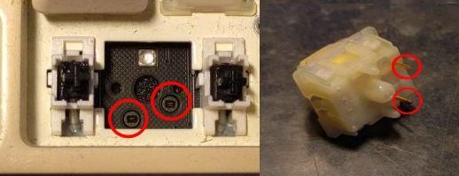

You can buy a different type of switches, it depends on your taste. I recommend Gateron switches since they are less expensive. If you want to enhance the light diffusion get the Gateron milk version since they are transparent. Check this video for more info on switches.
Also check that the switches are compatible with the board you bought. This means that you need to check the number of pins of the switches and the board in the details.

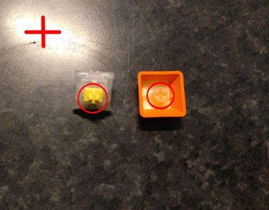

- Keycaps YMDK Double Shot 108:
I’m repeating myself. Same as before: choose the one that you like, consider that you need keycaps that are compatible with the switches that you buy. Don’t panic! This means that they just need to be “X” keycaps as the switches. The above picture is self-explanatory.

If a key is not functioning, the switch is not properly allocated inside the board. You need to check if it is correctly positioned or if the pin is bent.

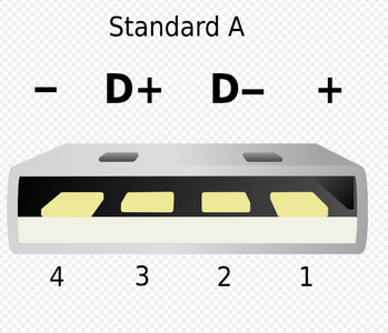

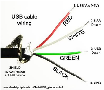

Step 10: OPTIONAL Soldering and Testing the Cable
Use the wire stripper to strip the USB cable. You should have 4 cables inside the 2.0 USB cable.
Open the GX Aviator connector and solder the cables on it. Use the previous video as a reference and these pictures. Consider that the color of the wires in the USB cable sometimes are different. If you have doubts on the position of the GND Data+ Data- and Vcc wires, use the short-circuit function on the multimeter.
If you put the multimeter plugs on the end of a cable the multimeter will either beep or show 0 (depends on the model). If it beeps it means that you made a short-circuit.
Connect the aviator connector and the USB cable to the keyboard and PC. Test the keyboard.
