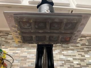

Step 1: 3D Print Main Part of Pallet
Print the main part of the pallet. I chose a rectangular pallet to best use the space of my small, rectangular build plate. The print design I used, from Thingiverse, by Rlundo, is attached.
I used a scraper and hammer to remove the print from the build plate: to do this, I took the build plate off my printer and placed it on a solid surface (my patio), then wedged the scraper between the build plate and print, and gently tapped the end of the scrapper's handle. This method could warp your build plate if you hammer too vigorously, so, use care.
