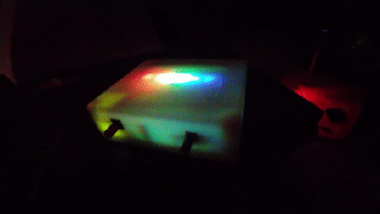

I wanted to build a Music Player which has a Unique playlist for each day. My Mom likes to listen devotional songs on Saturday and Thursday which has Playlist of Music files for Saturday and different Playlist Music files for Thursday.
My Goal is to make a Portable Playlist Music Player with LED Color Organ which will automatically play the playlist songs programmed to be played on that day only. Here I have only created and demonstrated only 2 playlist but you can create multiple playlist.

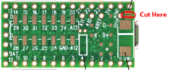

The Teensy 3.2 would be getting powered through External source i.e the Battery and not through USB. So we need to cut a Track To charge the Battery when USB Cable is Plugged in (see Images for reference) more on this you will see in PCB Section.

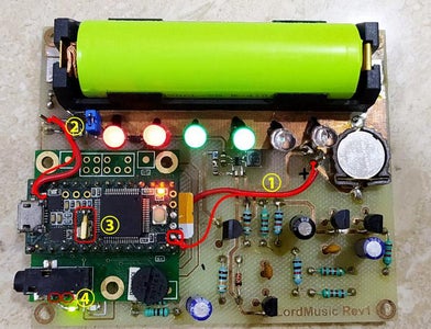

The PCB has been Designed using Altium Designer software. I used PCB Milling machine to mill my PCB.After PCB Manufacturing Assemble the Components as per the Assembly Diagram (see img for reference). I have also added the Image of the PCB after Assembly.

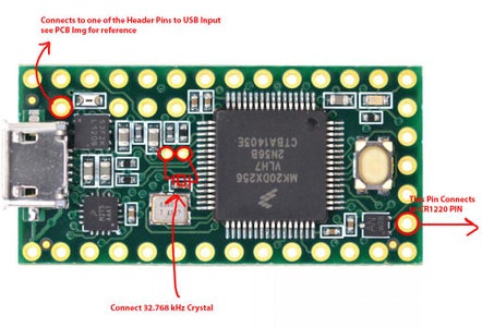

After Assembly is Completed there is Four IMPORTANT Steps(see img for reference) is to be Performed.
  1. Connect a wire from VBAT pin of Teensy 3.2 to the CR1220 pin see img for reference.
  2. Connect a wire from one of the pad near micro usb connector on the Teensy (see img for reference) to the header of USB Input of the PCB
  3. Add a 32.768kHz Crystal for RTC Time keeping
  4. This is critical step for LED Organ to work. Connect two wire Leads from Audio Adapter Board to the PCB on Audio Input Pads of the Base PCB. You would find difficulty in soldering the Leads

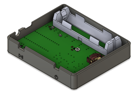

Step 3: CAD Design
This is my 1st CAD Design using Fusion 360. Tried my best, hope you will like it. There might be some filing necessary because the Audio Jack and Micro-USB Jack for me was not oriented properly so I had to do some filing on it.

You can see the attached Clip video to see the final working of the Device.
