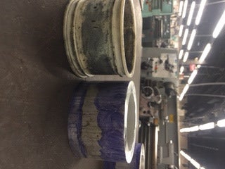

The wheels were cut from aluminum tubing rather than round stock to save time and cut cost, although the cost was still pretty expensive.
3-1/2" OD {A} x 2.500" ID {B} x .500" Wall {C} 6061-T6 Aluminum Tube (Tubing)-12" $33.26 w/ shipping
Step 3: Boring Bar
Next was to Bore the inner hubs flange, and test fit the 3D printed prototype.
Step 4: Mandrel Build
This step was tedious but an important part of the build. In order to get the specific tolerances needed out of the aluminum intense care was need. This Mandrel was fashioned to hold the Hub while the outer dimensions where cut.
Step 5: Balancing
After I fashioned my mandrel the wheel had to be balanced, using a height gauge and a three jaw chuck.`
