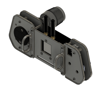

Step 1: Transmitter - Mechanical Design and Assembly
The major design requirements for this redesign of the transmitter were:
  1. Ergonomic but sturdy and rigid enough to hold power bank battery and joystick IO
  2. Minimal 3D printed parts
  3. Possible to add more user interfaces (ie - more switches, knobs, sliders in future)
  4. Compatibility with ArduRover input channel requirements
  5. Easy access for wiring routing and changing out plates (used standoffs)
  6. Each plate is 2mm thick with 40% infill (HIPS filament)

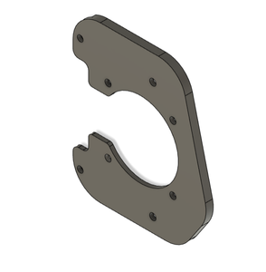

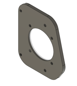

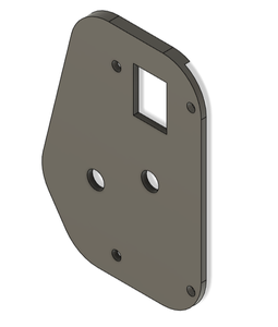

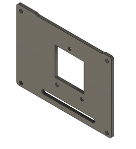

The various plates were as follows:
  1. LH Top Plate - switch and io panel mount
  2. LH Top Plate - for switch plate rigity (duplicated)
  3. RH Top Plate - for joystick panel mount
  4. RH Mid Plate - for joystick plate rigidity (same dimensions but with wire cutout)

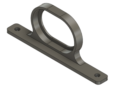

  5. Rear Plate - holds RFD900 and Battery bracket

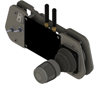

Step 4: Assembly Instructions
  1. The perfboard was secured to the top RH and top LH plates with M3 x 10 screws
  2. Standoffs ensure rigidity between the lower RH and lower LH plates. Assemble the two plates to the standoffs using M3 x 6 screws on both sides
  3. The RFD900 radio was fastened to the rear plate using the nylon standoffs and the same M3 x 6 screws
  4. The rear plate was secured to the bottom end of the main standoffs using the M3 x 10 screws
  5. The joystick is secured to the top RH plate with the provided screws
  6. Fasten the toggle switches with the hex nut and washer, inserting from below
  7. Insert the rocker switch to the top LH plate which is push-fit

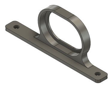

  8. The battery slots into the two sides of the battery brackets (should be secure fit)
  9. FTDI cable between RFD900 (USB-A male) connects into laptop (to give telemetry)
  10. See the exploded view and CAD of assembly for more details
