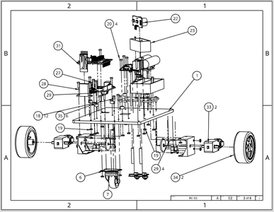

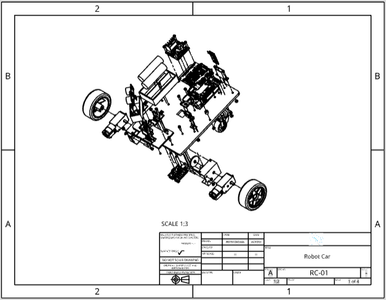

Step 2: Drivetrain and Swivel Caster
Supplies:
  • 4 10 m3 screws
  • 4 25 m3 screws
  • 8 nuts
  • 2 Geared Motors
  • 2 wheels
  • 2 3D printed motor mounts
  • 2 opto interrupters
  • 2 encoder disks
Step:
  1. Solder two wires to each motor
  2. Cut and splice the opto interrupter wires as well as add heatshrink to the joint
  3. Attach the opto interrupter to the small holes in the motor mount
  4. Attach the motor mount to the holes on the side with no face opposing it
  5. It should be attached where the opto interrupter is close to the ground
  6. Attach the wheel to the other side of the motor
  7. Your completed structure should look like picture 2 above
  8. Repeat steps 2-6 for the other motor
  9. Attach both motor structures to the chassis with the remaking screws, nuts, and holes
  10. It should look like picture 3
  11. Attach the swivel caster to the other side of the bot to look like picture 4

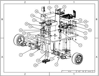

Step 3: Arduino Uno, Breakout Board, and Motor Controller
Supplies:
  • Arduino Uno
  • Breakout board
  • Motor Controller
  • 7 spacers
  • 7 10 m3 screws
  • 7 m3 nuts
Steps:
  1. Attach the Arduino Uno to the Chassis with 3 of each spacer, screw, and nut as such in picture 2
  2. Attach the breakout board to the Uno such it is aligned to the side without 2 ports sticking out(picture 3)
  3. Attach the Motor controller using the remaining 4 of each spacer, screw, and nut like in picture 4 above
