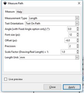

Inkscape can calculate how long this path is and tell us how long to make the flexible edge strip that goes around the outside of the box. "Extensions->Visualise Path->Measure Path". A "Measure Path" dialogue box will open, make sure the "Length Unit" is set to "mm" before you click the apply button. The measurement value will appear on the path.

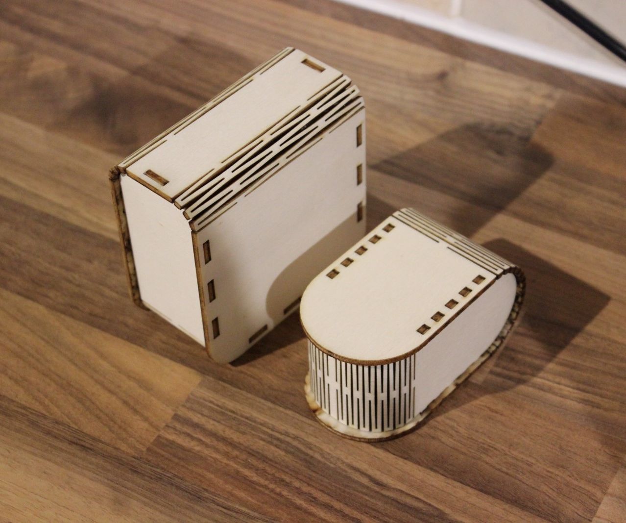

These are all the shapes you need to assemble a box. The final diagram shows the 5 panels you need to make to create the caps. The box is cut and assembled as per the other instructable. In our files we have optimised the layout slightly to reduce the material wastage and to make it fit into an A3 sheet. Switching back to display mode ("View->Display Mode->"Normal") at this point will allow you to set the colours for the different cut operations.
Step 3: Go Forth and Make Boxes
This technique can be applied to form lots of different shapes. So far we have made square boxes with rounded corners, egg shaped boxes and heart shaped boxes. We can't wait to see what designs you come up and please feel free to show us what you do make, don't forget to tweet us a pic https://twitter.com/addsharks.
