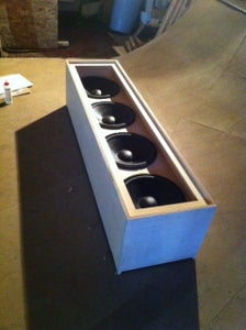

Step 2: ShopBot
Next you have to consider your tooling.
So I'm running this on the ShopBot with a 4ft x 8ft cutting bed.
I designed my file in Adobe Illustrator. My file consists of 4 sides, 2 of which have 3/4 inch feet for air flow, a piece that holds the speakers that slides in notches to support itself, and a face plate that also slides in notches to mount the fabric cover, but in this case its going to hold reflective fabric that will be bounced by the sound for the art piece.
Step 3: Notches
When cutting the notches I remind you that if you cut them perfectly to the dimensions the corners will be rounded due to the bit, so there are two options.
1: You can dog-bone the ends so a piece can slide in perfectly.
2: You can cut the notches past where you need them and when you run the profile it will cut the excess so your finished piece will be perfect. (see picture)
Step 4: Assembling
Once your pieces are cut out everything should just fit right together, so grab a friend and do a glue and nail up.
I used wood glue and 1 1/4in brads.
VIOLA !
VIOLA !
