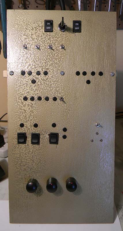

Introduction: Custom Switch Panel for a Flight Simulator
This is my first instructable. If I had thought I would have took pictures of the entire project while making it.
This instructable is just one example of how you can make a custom switch panel to add some realism to your flight sim. Is this the best? No, far from it, but hopefully it will show you how easy it is and you can go from there. This panel is very simply based off the DC-3, which is the airplane I fly most of the time.
Some things you will need:
Xinterface from www.FlightSimElectronics.com
T hin plywood, sheet metal, plastic, cardboard (reinforced with fiberglass), or what have you for panel
Switches and pushbuttons
N4004 Diodes
Soldering Iron
Solder
First, draw out on paper how you want your panel to function, with the layout of the switches and buttons. Draw your design on the plywood. Simply use a drill for the pushbutton holes. The square switches you will need to first drill at a corner, then use a jigsaw (or dremel?) to cut the square holes. Paint the panel however you wish, then insert all your switches and buttons. Solder up the switches per the Xinterface instructions (example, an On/Off switch with two posts will have a "column" wire on one terminal, and a "row" wire on the other. On/Off switches require a diode, but that's pretty simple and covered by the Xinterface).
Once you are wired up, you can mount your panel to your desk using some small screws, or you can attach it to a stand of some sort. Just plug in the USB connector, fire up your favorite flight simulator, and assign the joystick buttons (switches and pushbuttons) to the desired functions. That's it! Pretty simple, super cheap, and now you have a new dimension of fun!
You can also do this sort of thing for race car sims, train sims, and even make your own custom joysticks (for FPS's, World of Warcraft, whatever). Use your imagination! Thanks for looking!
