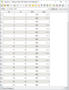

Calculate the 100-meter contour lines :
- Right-click the new Contour layer and choose Open Attribute Table.
- Click the Field Calculator button.
- Create an index for each 100-meter contour line. (Picture 4)
- Field name: index
- Expression: IF("ELEV" % 100 = 0, 1, NULL)

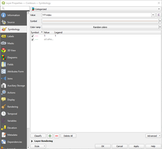

Change the display of topographic lines :
- Double-click on the Contours layer. (Picture 5)
- In the Symbology menu, change "Single Symbol" to "Categorized."
- Select index as the value.
- Click the Classify button.
- Click Apply.
- Open all the layers inside the Contours layer. Now, you will have two layers: one for each 20-meter contour line and another for each 100-meter contour line. (Picture 6)
