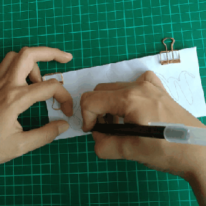

I wanted to decorate my own canvas totebag with a simple design, thus I decided to use the heat transfer vinyl for this project. I measured the width of the design that I wanted on the totebag and adjusted the design accordingly. I added lettering to my canvas totebag "Makers Gonna Make" using Gold and Black Heat Transfer Vinyl. Since I didn't have a cutting machine, so I needed to print the design on a paper (don't forget to mirror/reverse the design). Then, I put the paper on the heat transfer vinyl to hand-cut it based on the design on the paper. This is quite tricky, so if you have a cutting machine, that would really help.
When cutting heat transfer vinyl, always make sure the heat transfer vinyl is shiny down when cutting.
Once it is all cut then you need to weed the design which is just removing the excess vinyl we don't want attaching to the totebag.

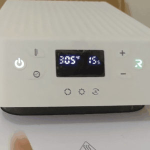

Introducing the HTVRONT Auto Heat Press easy button and display:
  1. Power button. Will blink after you plug the HTVRONT Auto Heat Press
  2. Temperature button. To set the temperature (see "a" on display screen). Press long to change from default Fahrenheit to Celcius. Max Temperature: 410° F (210 °C)
  3. Timer button. To set the timer (see "b" on display screen )
  4. Plus button. To increase the temperature or timer
  5. Minus button. To decrease the temperature or timer
  6. R button. Wait until it turns to green light to start pressing(red light indicating that the HTVRONT Auto Heat Press still in the process of heating up to the desired temperature).
All we have to do is activate the device by engaging the power button. It will require approximately 6 minutes to reach the default temperature (210° F).
Take a moment to consult the guidelines provided with your HTV packaging to determine the appropriate temperature and duration for pressing the specific vinyl. Proceed to adjust these settings on the machine and allow it to reach the desired temperature.

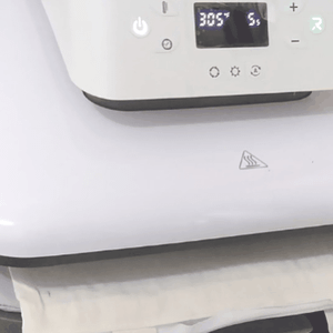

For most HTV projects, it is advisable to briefly preheat the garment, enabling better adherence of the vinyl, iron out any wrinkles and eliminating any moisture within the fabric. For my totebag, I adjust the temperature to 305° F and the timer was 5 seconds.

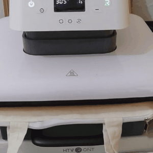

Pull the handle on the HTVRONT Auto Heat Press and slide out the tray with the heat pad on it. Set the canvas totebag on the pad, making sure it is laying flat. You can use a lint roller to eliminate any lint, and then smoothly insert the mat before pressing the green R button. Subsequently, the HTVRONT Auto Heat Press will automatically apply pressure to the heating pad, following the pre-set temperature and duration. When the time is up, it will also automatically lift up the press! It's so easy and effortless!

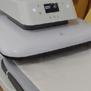

Now that the totebag has been warmed up, it's time to introduce the design! Gently press the vinyl down, cover them with the Teflon sheet, and glide them into the press. Once the correct temperature and duration specified on your HTV package have been set (I used 305° F and adjust the timer to 15 seconds), press the start button and allow the magic to unfold!

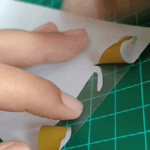

Next, you should refer to your instructions to determine whether a warm or cold peel is recommended. In the case of a cold peel, wait for the vinyl to cool for a minimum of 30 seconds before delicately removing the carrier sheet. Voila! It looks splendid!
