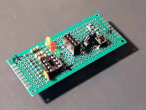

Step 15: Making the Final Working Board, Some Ideas for Improvement
At this point you should have:
  • a 100% working prototype, with the code uploaded onto the Attiny, and tested with it connected to the system and all the components, using a breadboard (or you're just confident that you programmed it right in the first go :-) );
  • the stereo system reassembled.
Now you can get to soldering. For this purpose I used a universal PCB, but you can do it your way - etch one yourself or even order a professionally made one via JLCPCB or the like if you have the skills to design it (I only made the simple schematics attached so can't help you with this one).
In the pictures attached you can see the final contraption as I made it. I like the raw look on the front panel of my stereo, but if you like things more neat and tidy, you could make it on 2 PCBs - one hidden inside the case, with the microcontroller, BT module and other bits there, and one exposed on the front panel, with just the buttons and LEDs (maybe even cut to the shape of the knob hole and pushed inside it). Putting custom 3D-printed buttons on top of it would be extra-pro.
Note that I soldered a few single-pin headers around my board to act as guides/mounting points for putting the PCB on the front panel. After some tinkering they squeeze tightly into the volume knob hole and hold the whole thing quite firmly in place.
That's all for today folks, I hoped you liked my first ever instructable. Cheers!
