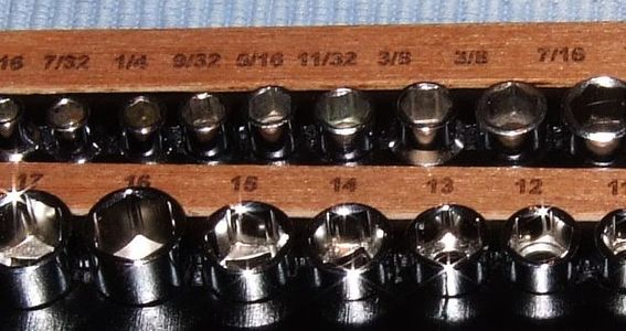

Step 3: Making the Socket Labels
Next I used the laser cutter/etcher at the TechShop to make socket labels (from a bit of the scrap lauan plywood) for both the SAE and Metric socket set.
After etching the labels on the lauan, I cut the two stips of labels out with the table saw and rounded the corners a bit on the disc sander. I then sprayed a clear coat on the labels to minimize the impact of the inevitable grease they would experience.

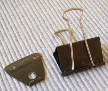

Step 5: Making a Latch
Finally I had to buy or make a latch to hold the lid closed. I found it surprisingly difficult to find a latch small enough for the application, so I made my own from a binder clip.

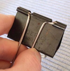

First I removed the pivoting handles by folding them back and squeezing inward - one side at a time.
Then I opened the binder clip with a couple of pairs of pliers and a bench vice. I bent the two creases as flat as possible with the vice and then hammered the creases on the flat surface on the back of the vice to really get them flat.
Then I cut out the shape of the latch using a Dremel tool with a carbide wheel. I then shaped it a bit with the bench grinder and removed the sharp edges.
