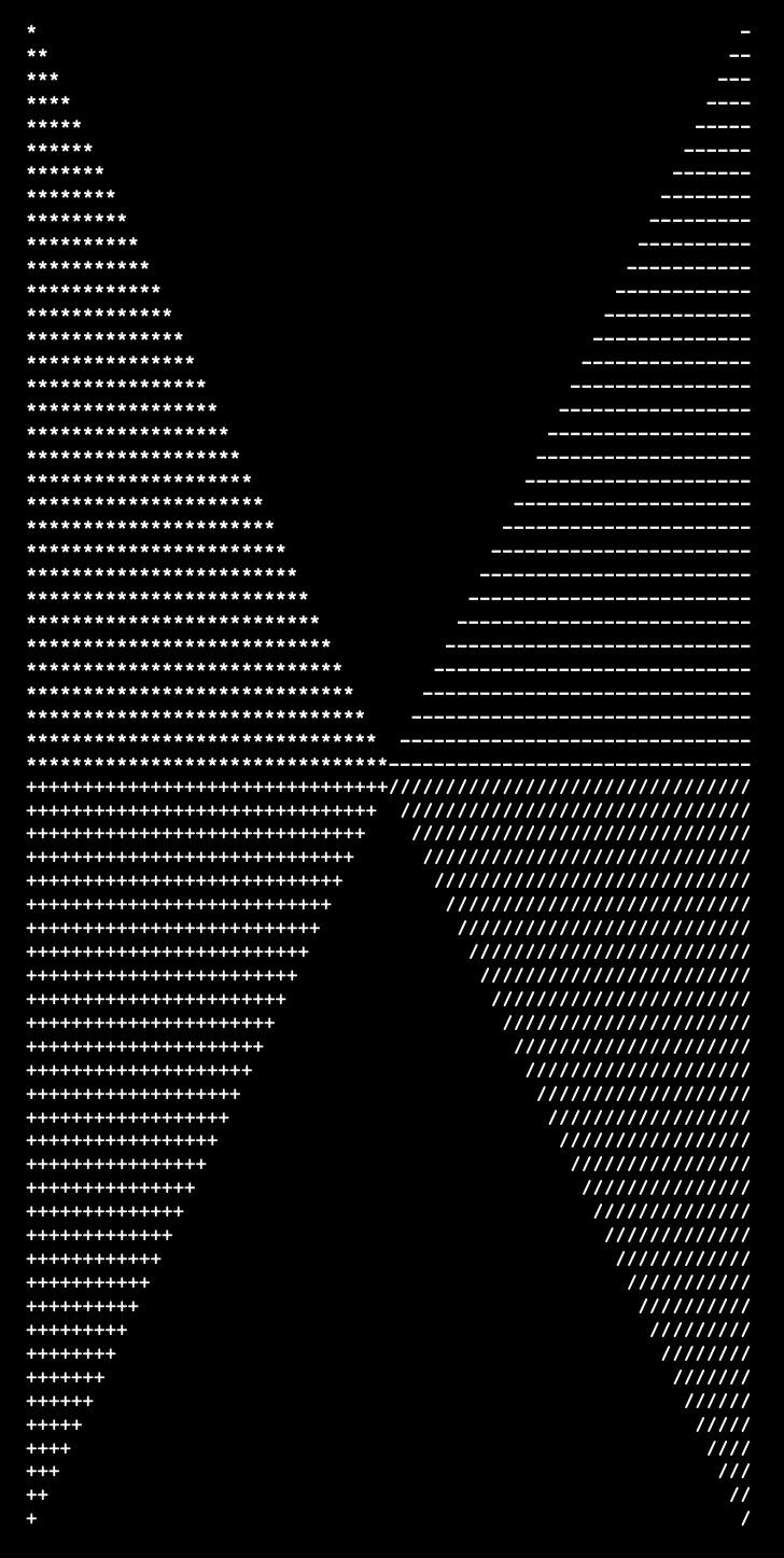

Step 3: Example Output (for Rows = 3):
To give a basic explanation of this step, lets run this code when rows = 3. You will get something like this:
As you can see, 2 vividly visible triangles are generated, but thats not it! We need to go further.

Step 5: Example Output (for Rows = 3):
Considering only the bottom portion, we can get an output like this:
However, by making both codes run together, we get this:
It may not look significant, but it is the base of the code. By altering the row number and changing the operations, things change drastically!

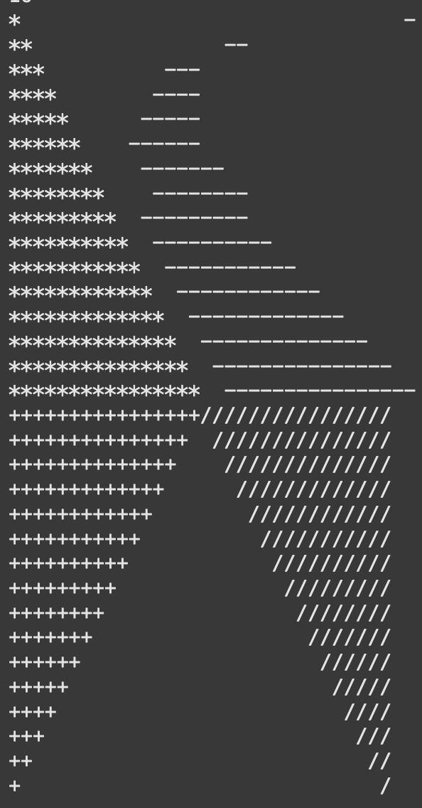

Step 9: Making Changes
Lets make changes to the input. For this, I will use 16 as the number of rows,
Step 10: Upper Section Change
print("*" * i + " " * (2 * (rows // i)) + "-" * i)
• rows // i: Replaces rows - i with integer division. This creates uneven spacing because the number of spaces depends on the ratio of rows to i, which decreases as i increases.
Impact: The alignment of stars and hyphens becomes non-linear, introducing a unique asymmetry.

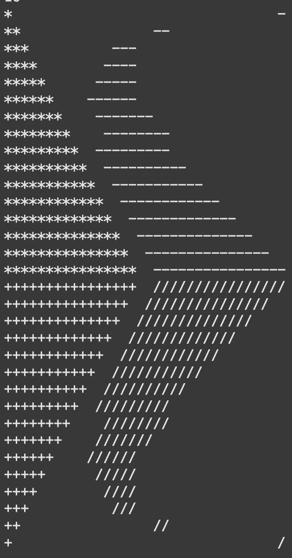

Step 11: Lower Section Change
print("+" * i + " " * (2 * (rows // i)) + "/" * i)
Effect: Similarly, the spaces in the lower section now vary dynamically with the decreasing value of i, leading to an uneven alignment of plus signs and slashes.

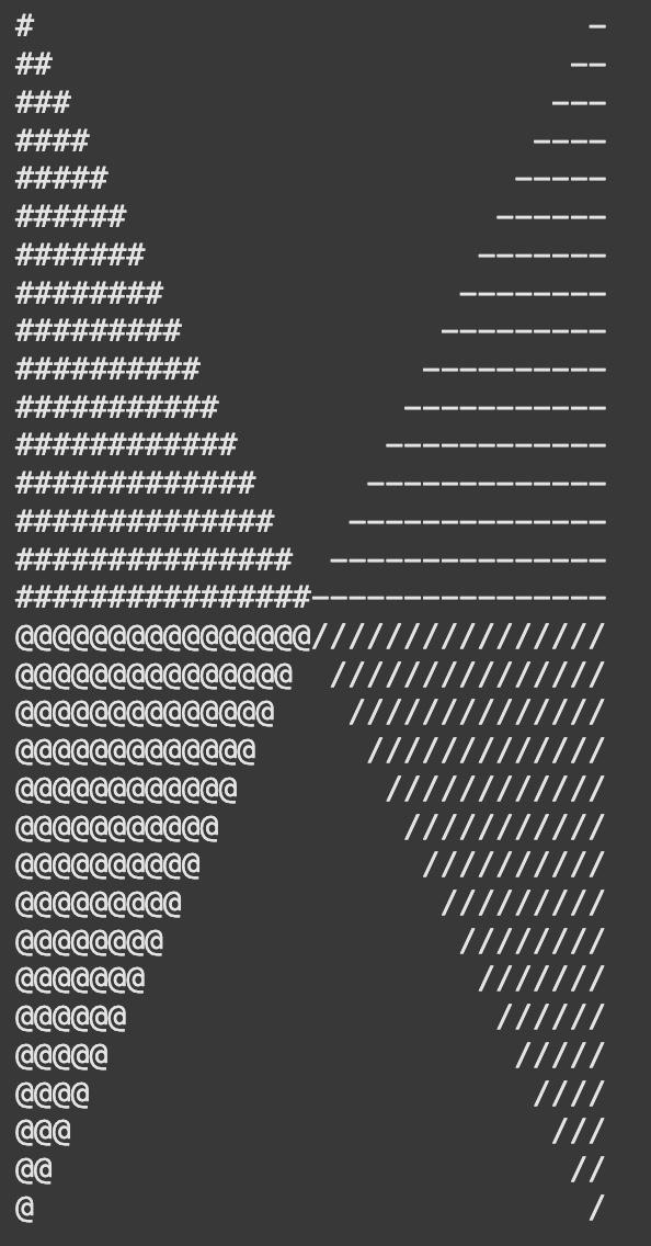

This gives a swirly effect which looks great when the number of rows are increased
Step 12: Conclusion
This Python program creatively uses loops, string multiplication, and input validation to produce a symmetric arrow pattern. Adjusting mathematical symbols or ranges alters the design, providing a versatile framework for pattern generation. By understanding its logic, users can customize and expand this program for various designs.
This truly was amazing for me. Create replicas of this program and feel free to adjust even more operations and create unique patterns, or even increase the number of patterns altogether! Post it on the "I Made It" section, where I will personally comment on your expertise.
