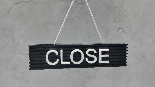

Step 10: Assembling Name Plate (open N Close)
1. Prepare the Parts:
  • Once all the components are 3D printed, gather them together for assembly. Ensure you have the nameplate, letters, and thread ready.
2. Joining plates together:
  • Join two same-sized name plates together using double-sided tape, make sure that both sides have slots for placing letters in it.
  • Attach the thread between the two plates for hanging.
3. Insert the Letters:
  • Place the letters into the slots on the nameplate. Arrange them to display the desired name or message. Ensure each letter fits snugly and is properly aligned.
  • Now secure all the letters using super glue.
4. Final Touches:
  • Check the overall assembly for any loose parts or misalignments. Make any necessary adjustments to ensure a polished and professional appearance.
A perfect make for your Workplace! Simple flip in the morning and in the evening.
