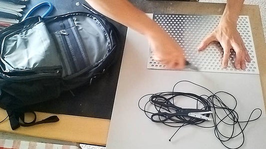

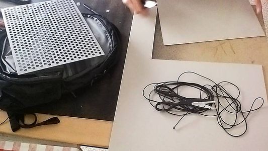

Step 2: Cut a Same Size Cardboard As Your Aluminium Plate
If the aluminium base plate doesn't fit in your bag, it must be trimmed down. I made it fit the front compartment of my bag exactly.
The aluminium is difficult to cut. So I first tweak a piece of cardboard to have the correct shape, and then transfer that to the aluminium, so it can be cut to the right shape in 1 go.
So first cut out a piece of cardboard the same size as your aluminium plate.
Step 3: Tweak the Cardboard to Fit in Bag Compartment
The cardboard (or paper) has the same size as the aluminium plate. It can be manipulated easlily to give it the desired shape.
Because the bag is symmetrical wrt the middle line, I want the insert to be symmetrical too. So I make a shallow cut through the middle of the cardboard to create a fold line, and fold it in two along that line.
Now if I cut away a piece from the edge, the cut will appear symmetrically on both sides of the board.
So I just trim it down this way, until it fits.
