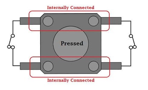

Personally this is where I slightly messed up with both the placing of the components on the perfboard and the soldering causing two buttons on the right to work inconsistently.
I reworked the placing on the perfboard in the attached image above and if you solder better than I did then it should work perfectly fine.
Also! When soldering the two cables to the button make sure you don'tsolder them both to the internally connected side. I had to unfortunately learn about this the hard way.
