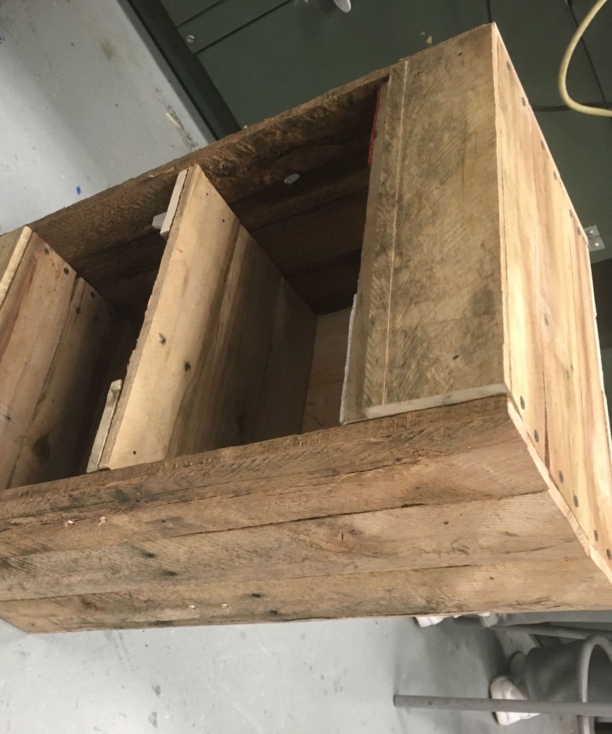

Step 3: Step 1: Create the Ledge (optional)
For two of the longer pieces, there needs to be a ledge for the 3D printed pieces to sit down in to. This can be done by creating dadoes using either a router table or running multiple passes on a table saw along the edge. If the thin edge of the workpiece is the top, the dimensions of the ledges are 3/16" deep by 1/4" wide.
Step 4: Step 2: Creating the Box Base
The next step is to assemble the box base to hold the 3D printed attachments.
1.) Using wood glue at all the mating surfaces, create the box by sitting the flat edge of the two long pieces with ledges on top of the remaining long piece flush with the edge. Make sure the ledges are facing towards the inside of the box.
2.)Then place the two shorter pieces on the ends standing up with the short side flush with the ground and the wide faces flush with the three ends of the long pieces.
3.) Clamp between the two outer short pieces, wipe any excess, and allow the glue to dry.
Tip: place one of the inserts onto the ledges when clamping to ensure the gap is set properly
Step 5: Step 3: Customize!
After the glue has dried fully, unclamp the box and slip your desired attachments down in to the box by sitting the flat edges on the ledge. This should create a snug fit that can slide along the edges.
That's it! Your easy to make desk caddy can now be stained, painted, rearranged, and customized to your hearts desire! Please leave comments for any future attachment ideas and post any makes. Happy building!
