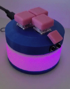

Introduction: Customizable Keypad
Missing a few extra buttons in your workplace? Want something that shines and blinks at you? Need a place to hide those secret love notes you keep receiving?
Then this programmable, Teensy/Arduino-Based, Button Pad is the thing for you!
I am a student at the Technical University Vienna and I want to share this little Project with you.

Step 1: Get to Know the Button Pad
To put it simply, this Button Pad is a very small keyboard with LEDs. The layout, if you just flash the microcontroller with the code as is, will have the top 2 keys mapped as Volume Up/Down respectively and the bottom key as Play/Pause. Holding down the “Layer Change” button, which is the one located on the canted surface, will map the top 2 keys as Previous/Next Track respectively while the bottom key will cycle through the LED animations (think of the “Layer Change” like the “Fn” button on laptop keyboards)
The two buttons on the circumference of the Pad are there to make programming and resetting the microcontroller easier, as you will not have to take the pad apart. One will put the Teensy into programming mode, while the other will reset it.

Step 3: Get Soldering
I found it easiest to solder the wires to the switches and Neo Pixel ring, snip off the unused legs of the momentary buttons, then route the wires through the channels to the center of the “button_plate”, put all the switches and buttons into position, trim the wires if necessary and lastly solder directly to the pins of the microcontroller.

Step 4: Get Everything Into Place
Once every part has its wires attached and other modifications made, I routed everything and put the pieces into their places. I had to trim a fair bit off the wires, as I cut mine too long. There is room for some slack in the wires, so that you can still take out the microcontroller, but it is a fairly tight space.
