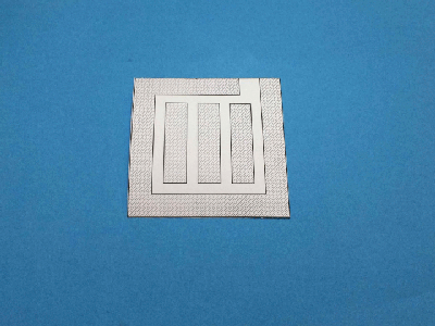

Step 5: Add Conductive Layer
First, stick double-sided tape to the shaded region of the bottom layer then peal out the protective layer of the middle sections one by one and lay down wire such that only the strands of wire are on the double-sided tape then stick the tinfoil strips on the tape such that it covers the whole tape otherwise the layer will stick together leading to false button triggers.

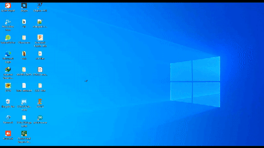

Step 12: Add Shortcuts to Desktop
To add a shortcut for any application/folder/ webpage just right click and go to properties of the application and you will find a shortcut field, click here and enter your desired key for the shortcut.
Do note that you only need to press the key of your choice, Ctrl + Alt is by default present in the shortcut.
To add a shortcut to any webpage just right click and go to New -> Shortcut and paste the hyperlink to the desired webpage.
