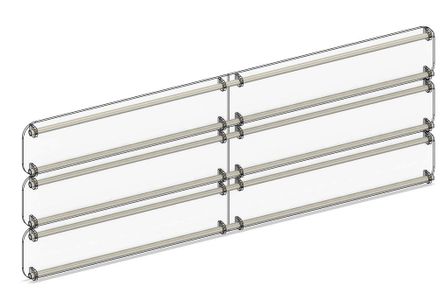

Step 4: Design Board
Because we have a 24" by 12" laser cutter, we decided that we should split each board in half, so 24" by 6", and join them to make our board a total of 48" by 6".
- Note our boards were not actually 24" by 12" but often closer to 23.8" by 11.9".
Next, we designed the rod holders and put them in all 4 corners (see image for our measurements). These hold our two rods that create a parallel circuit with our letters (top rod positive, bottom rod negative).
Note we didn't want to screw the boards directly on the wall and thus didn't design screw holes on our boards. For our mounting mechanism refer to Step 8.
We designed the entire board in Fusion 360 and exported the sketch as a SVG file that we opened in Adobe Illustrator so that we could send it to our laser cutter.
Step 5: Assemble Board
Once we laser cut all of the boards and the rod holders, we prepared a place to glue to the boards (using butcher paper) and used a toothpick to apply the acrylic cement onto the rod holders and put them into their slots.
We glued them with the rods in so the rod holders would be upright and align with the others.
Also we placed weights on the rod holders to keep them in place when the glue expands.
We did not glue the two halves together because we wanted to have the option to take it apart for transportation.
