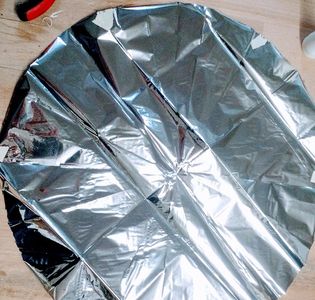

Step 4: Recovery System
For a save return to mother earth, we are going to need some device that decelerates the rocket and all its parts. You can achieve that effect with a glider, a gyrocopter, or a parachute. We choose a parachute. Fitting to the theme we choose a space blanket (can be found in expired first aid kits) because it's especially low-weight, low-bulk.
Form
Choose a form of the parachute silk that supports a gliding motion (we encourage you to have some fun experimenting).

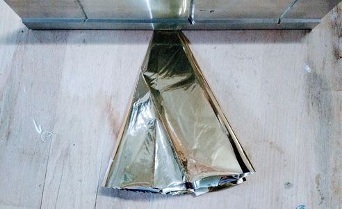

Fold
Fold it in a way that makes it likely to open on its drop down.
Assemble the Parachute
Fix the parachute to a string system. We used kite string.
- Punch small holes in the edges of the parachute.
Before you do, reinforce the hole borders before with some Scotch tape! - Fix the strings to the parachute.
Make sure all the strings are the same length!
