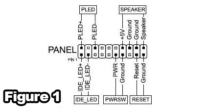

Before we fill a breadboard up with wires I think its important that we understand how the PC turns on. A motherboard has a series of pins like the ones in Figure 1. These pins are connect to the computers case via cables and allow us to turn the computer on/off, reset the computer, see an LED when the computers turned on, see an LED when the computers reading from its hard drive, and hear beeps to troubleshoot in the event of a problem. The only one of these we will need as you can guess is the on/off button. This button when pressed in allows a connection that shorts the two pins and makes the computer turn on. Our goal is to hijack that press so that it triggers our device and still turns the computer on.

The cables that go to our motherboard will plug into the pins labeled PWRSW. (this name can vary from board to board but it should be something like "power switch")
The cables that go to the power switch simply plug into the female end your computer cases power button.
