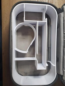

Step 4: Designing Your Insert
To begin this step you want to take measurements of all the parts you're designing around in the orientation you thought of.
It can be helpful to make a small list of measurements or write them in your sketch.
  1. Start, by building off of the design you already have for your test piece, and begin making the outlines of your parts inside the boundaries of your insert
  2. Try to combine walls as frequently as possible to help save all the space you can, I found 2mm walls worked great for the inside walls and 2.5mm works well for the outside walls as they were stable enough to hold the parts but also flexible enough to give you a bit of tolerance in case your original insert measurements weren't perfect.
  3. For complex shapes like the tape measure shown above it can be helpful to break the shape up into different simpler shapes. Make sure to keep in mind that your walls also don't have to perfectly conform to these shapes as long as they have a few contact points they should keep the part in place.
  4. Extrude the walls of your part and try to experiment with different heights to make an open space as mentioned before or to fit parts better.
  5. Make cutouts in the walls where you will be accessing your parts so that you can more easily take out the items you're using.
  6. Fillet the edges of the walls to prevent scrapes on corners and sharp edges, I found a fillet of 0.6mm works best for printing and reducing sharp edges (this is epically important around the cutouts as you will be interacting with those parts more often).

There are no remarkably special printing settings, however, for the sake of reference, these were the settings I used that worked for my printer.
  • Printer: Prusa MK3s
  • Filament: PLA
  • Layer height: 0.2mm
  • Infill 20% - Gyroid
  • Perimeters 2

Attached is the file to the insert I designed for the Satch Pencil Case.
