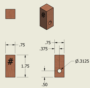

Using a 5/16" drill bit and my jig, I drilled holes in the sides of all the number blocks. Go slow here. I had one break, out of the nine I needed. Having a couple of extra blocks cut out is a good idea. I used a 5/16" drill bit and drilled 1/2" up from the bottom in the center of the block.

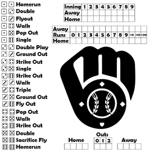

Before the pandemic hit, my brother-in-law sent me the photo of the baseball game pictured above. He wanted me to make him one.

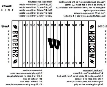

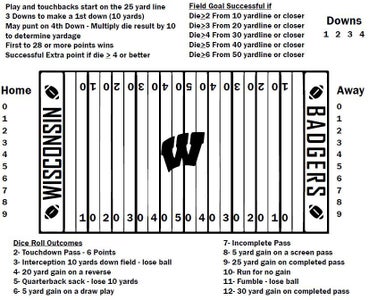

Also around the same time I found this football game at a resale shop.
I thought to myself, "Self, I can make some improvements on these." Long story short, I did. I made a couple of games on a laser and sent them out to him.
For this project I chose to use Football and Baseball on my box. I have already done projects with cribbage, so I decided to skip that option.

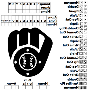

For this ink transfer, I did not use any medium. I printed the reversed image on the waxy part of a address label printer sheet. I just removed all of the labels and used an inkjet printer. I then carefully taped the image to the location of the wood and, using a credit card, I smoothed out the image onto the wood. Immediately after, I sprayed the wood with a coat of lacquer to seal the ink. This was my first time ever doing this. You can use color if you would like to, but I thought the text looked best just as a black void...just like our souls while we sat in front of computers for 8 hours a day.

Using some carbon paper, I transferred over the numbers onto my number blocks. I did try an ink transfer, but the numbers were too small and difficult for me to do this. Instead, I just used a wood burning tool and went to town...unlike during the pandemic.
