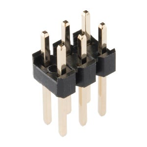

  • 6POS 2-Raw Male Header for ISP

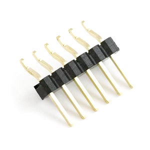

  • Right-Angle Male Header 0.1" for FTDI

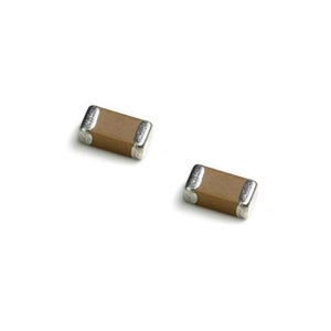

  • 1uf Bypass/Decoupling Capacitor
