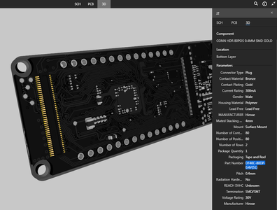

Actually Arduino community makes it easy through their Store web-page where they are posting "Interactive Board Viewer" that shows Portenta product in SCH mode, PCB mode and 3D mode. This feature is powered by Altium 365, all board components are clickable and you can just show-up the component's proprieties and there you get the part number as reference to use it while you search for your needed components.
The Mezzanine connectors used in the Portenta H7 board are Surface mount 80 pins HDR connectors by HIROSE manufacturer (this is why we call it HRS conn) and their part number is DF40C-80DP-0.4V(51), looking through the manufacturer datasheet it says that the appropriate male connectors for such reference is the DF40C-80DS-0.4V(51) and this is exactly what we used in our schematic design.

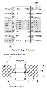

I added some LEDs to my design to perform some programming tests on the digital and PWM pins, some slide switches for digital inputs, it’s good to have also a motor driver for some power control, and I added a MAX6675 to test the ability of executing some libraries on my code.

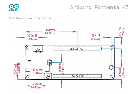

I arranged my componets inside the board outline area for a size of about 106mm x 58mm , compact and suitable to connect the Portenta H7 and to practice by exploring the circuit board components.
I respected the header to header spacing to match the Portenta layout, the accurate measures of the EDA tool helped a lot in this part, you can even get the Altium design files of the Arduino Portenta to be sure that you are moving through the right path, because Arduino Portenta board has been designed through Altium designer. I also Created a "PCB heat sink" for the motor driver by placing a solid copper region under the part footprint, this was mentioned on the part datasheet and remember that we need to always follow the datasheet's data.

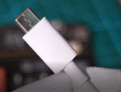

I run my Arduino IDE, no configuration needed for the latest version so I directly uploaded a blink LED sketch to my board. Oh hey! you will need a USB Type C cable for this Arduino board.
