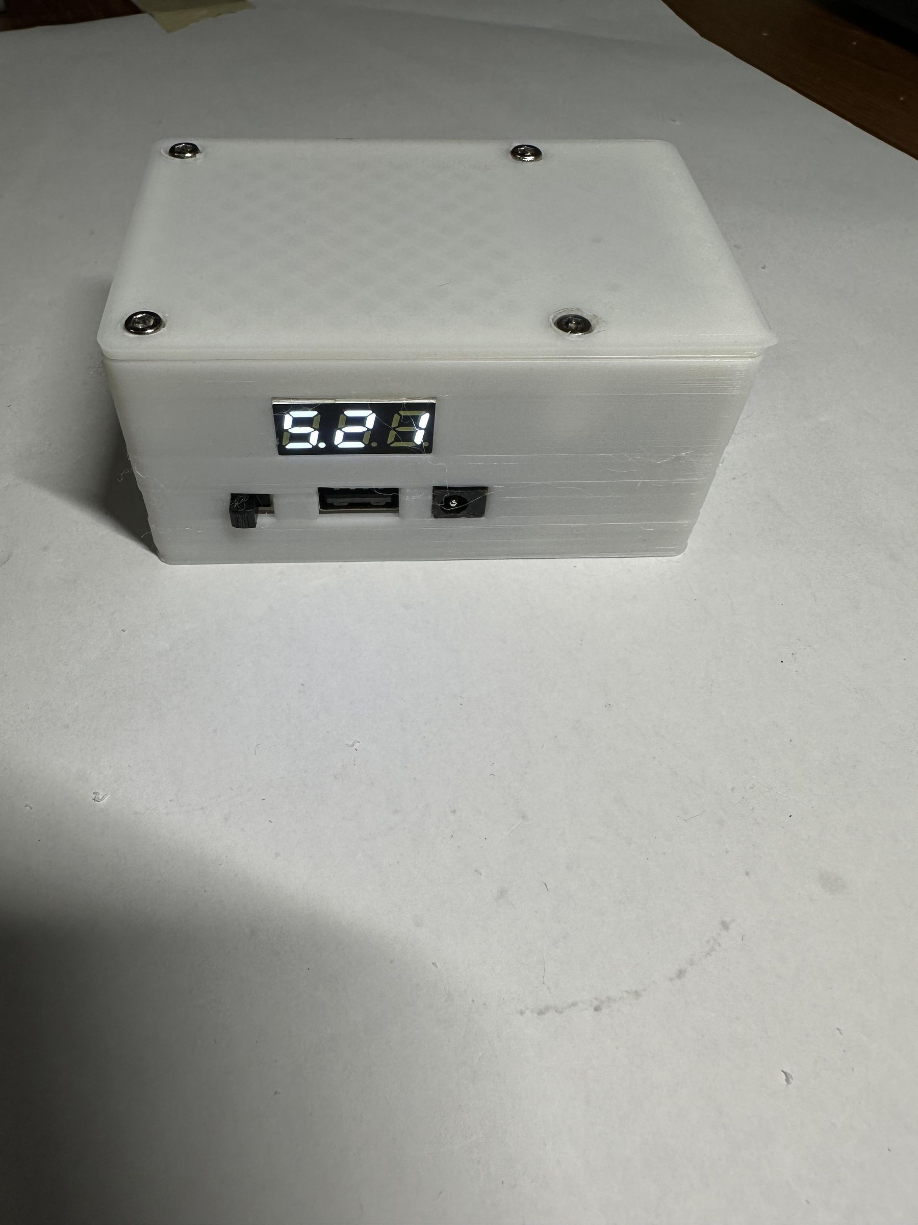

Step 1: Connect the Parts
This is a pretty easy build that only requires a few wires to be soldered. Start with 7 Dupont wires about 120 to 150mm long. One end needs a female connector to attached the Pi's GPIO pins and the other will be cut off. At the end that is cut off, trim a bit of the insulation so the bare end can be soldered to the amp, or push button switch.
The wires will be connected as follows:
  • Yellow from BCLK on amp to GPIO 18
  • Green from LRC on amp to GPIO 19
  • Blue from DIN on amp to GPIO 21
  • Red 1 from Vin on amp to 3.3v on PI
  • Black 1 from GND on amp to Ground on Pi
  • Red 2 from one side of switch to GPIO 16
  • Black 2 from other side of switch to Ground on Pi
Solder the two speaker wires to the + and - solder points at the top of the amp board
(see https://learn.adafruit.com/robotic-ai-bear-using-chatgpt/circuit-diagram for a visual of the wiring. Ignore anything to do with Motor Wiring)
After you attach the wires to the Pi and push the Pi into the bottom part of the case you can plug the USB microphone into any of the USB ports on the Pi.
Secure the top part of the case to the bottom part using either 28mm M2.5 screws or, as I did, 20mm M2.5 screws with a small M2.5 spacer to extend it. If you like you can just push the two halves of the case together and since it's a pretty snug fit you may decide to add the screws later or not at all.
