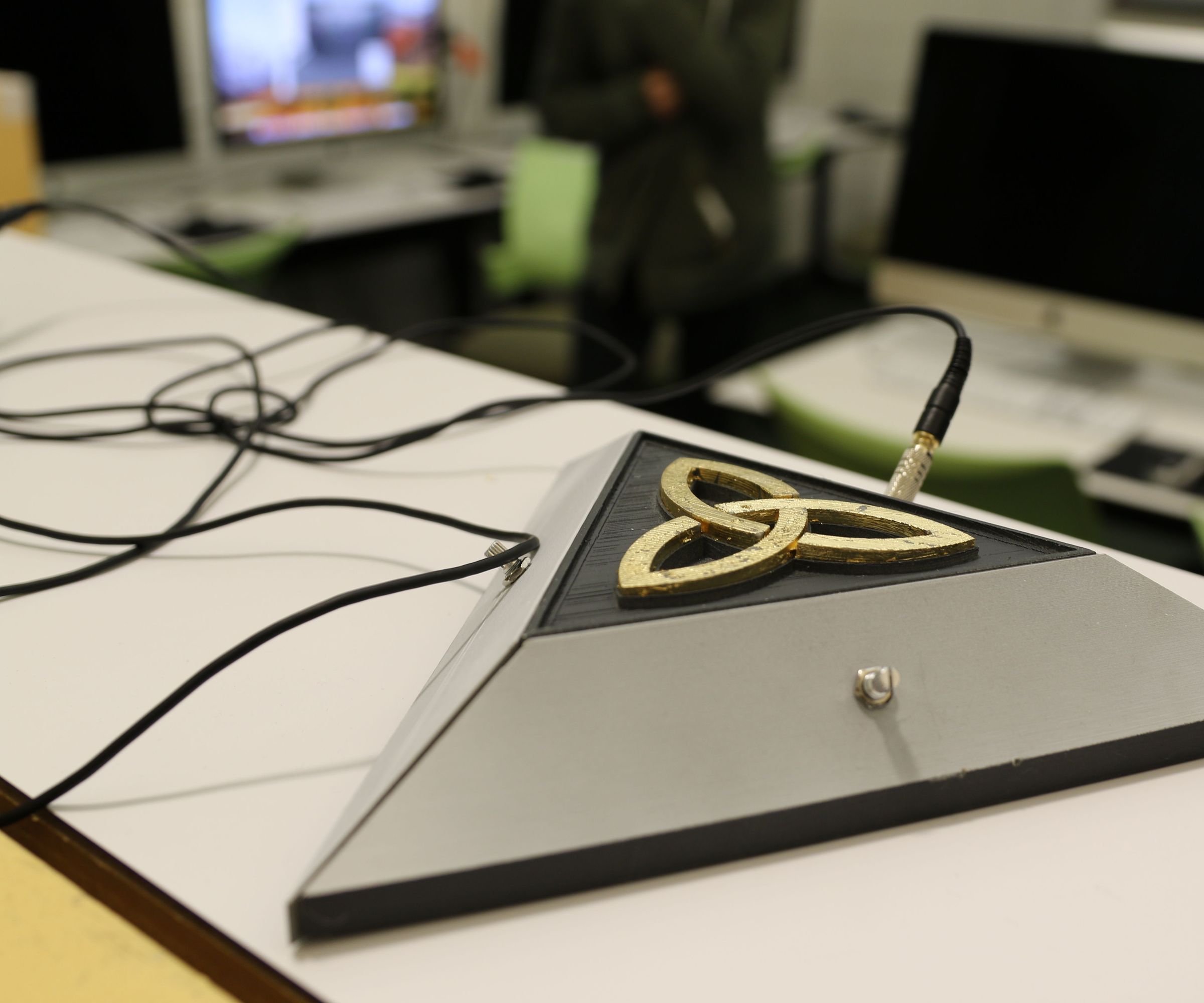

Introduction: Customizing PulseSensor Visualizer to Trigger Event (Anti-Productivity Monitor)
In this instructable you will be learning how to modify the PulseSensor Visualizer Program to trigger an event in a web browser. I am calling this project the Anti Productivity Monitor because while we have many tools that help us monitor our vitals, our schedules, and our food intake, there isn't much out there that reminds us to take a few minutes out of our busy days to slow down and breathe.
