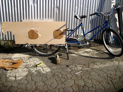

In the first stage of a custom bike, you need to think fast and generate lots of ideas. At this point I was just trying to put all the objects into my workspace: her skate, the speakers, the Xtracycle frame, etc. This way you can quickly get a sense of the sizes of the objects and make decisions about where things go, what can fit, and how it looks in proportion to the bike.

Rather than teach woodworking, I'll just say that you will need a ton of good clamps, of all sizes. So be on the lookout for those next time you're at the flea market. As you can see, I cut this box at an angle, so that the top would be narrower than the bottom. This allows the woofer to angle up, which directs the sound to ear level.
