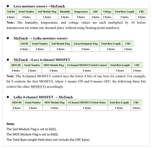

Step 1: Data Packet Format
We modified the LoRa transmission and reception part by adding a custom protocol, which includes CRC validation and data acknowledgment. On top of the original system, we added:
  1. CRC is appended to each data packet to verify data integrity and correctness during transmission and reception.
  2. An acknowledgment mechanism is implemented on both the LoRa transmitter and receiver sides to guarantee that the receiver has successfully received the transmitted data.

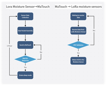

Step 2: LoRa Communication Protocol From Lora Moisture Sensor to MaTouch
Lora Moisture Sensor→MaTouch
  1. Sensor Data Collection
We amplify the collected data by 10 times before transmission, preserves one decimal place while saving space.
temperature = humiditySensor.getTemperature();
humidity = humiditySensor.getHumidity();
temp_value = (uint16_t)(temperature * 10);
humi_value = (uint16_t)(humidity * 10);
  1. Data Packet Assembly
The data length is added to the packet to provide the receiver with a CRC calculation;
uint8_t len = i;
send_data[i++] = len;
And the CRC value is calculated once locally to provide the receiver with a comparison.
uint16_t crc = CRC16_CCITT(send_data, len);
send_data[i++] = crc >> 8;
send_data[i++] = crc & 0xff;
  1. Send to MaTouch
radio.transmit(send_data, i);
  1. Wait for Response
Upon receiving an acknowledgment from MaTouch, the sensor enters sleep mode.
if (command_explain(receive_data))
Serial.println("rx ok!!! go to sleep");
radio.sleep();
packetnum++;
readSensorStatus = false;
digitalWrite(SENSOR_POWER_PIN, LOW); // Sensor/RF95 power off
delay(100);
rx_timeout_cnts = 0;
lora_mode = Lora_Sleep;
break;
Otherwise, it will retry sending. If no acknowledgment is received after two retries, the sensor enters sleep mode.
else if (state == ERR_RX_TIMEOUT)
// timeout occurred while waiting for a packet
Serial.println(F("timeout!"));
rx_timeout_cnts++;
if(rx_timeout_cnts > 2)
lora_mode = Lora_Init;
break;
MaTouch → LoRa moisture sensors
  1. Receive Data from LoRa Moisture Sensor
  2. CRC Validation
uint16_t analyse_crc = CRC16_CCITT(data, data[16]); // Calculate the CRC
uint16_t crc = (data[17] << 8) | data[18]; // Extract the CRC value from the data packet
If the CRC check passes, a confirmation packet is sent back to the LoRa Moisture Sensor, and the soil moisture value is displayed on the screen.
if(analyse_crc == crc)
Serial.print("CRC check pass");
If the CRC check fails, the system continues waiting to receive data.
else
start_receive();

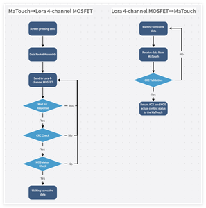

Step 3: LoRa Communication Protocol From MaTouch to MOSFET
MaTouch→Lora 4-channel MOSFET
  1. After pressing the Send button on the screen, the system starts building the data packet.
The packet includes the MOS value set on the screen, the data length (for CRC calculation on the receiver side), and a locally calculated CRC value for verification.
lora_send_len = 0;
memset(lora_send_data, 0, sizeof(lora_send_data));
memcpy(lora_send_data, mos_id0, 6); //MOS ID
lora_send_len += 6;
mos0_cnts++;
lora_send_data[lora_send_len++] = mos0_cnts >> 8; //Serial Number
lora_send_data[lora_send_len++] = mos0_cnts & 0xff;
lora_send_data[lora_send_len++] = 0x02; //MOS Module Flag
lora_send_data[lora_send_len++] = mos0_control_flag; //4-Channel MOSFET Switch Control
uint8_t len = lora_send_len;
lora_send_data[lora_send_len++] = len; //Total Byte Length
uint16_t crc_mos0_send = CRC16_CCITT(lora_send_data, len); //CRC
lora_send_data[lora_send_len++] = crc_mos0_send >> 8;
lora_send_data[lora_send_len++] = crc_mos0_send & 0xff;
  1. Send to Lora 4-channel MOSFET
radio.transmit(lora_send_data, lora_send_len);
  1. Wait for a response
start_receive();
memset(receive_data, 0, sizeof(receive_data));
recv_interrupt_flag = true;
Upon receiving a reply from the LoRa 4-Channel MOSFET, the system performs a CRC check.
uint16_t mos_analyse_crc = CRC16_CCITT(data, data[10]);
uint16_t mos_crc = (data[11] << 8) | data[12];
If CRC validation, verifies whether the actual MOS status matches the intended control state.
If status match pass, the system enters data-receiving mode.
Otherwise, the system resending the packet.
if((memcmp(data, mos_id0, 6) == 0) && mos0_control_flag == data[9])
Serial.print("mos_id0 control ok!\n");
lv_label_set_text(ui_Label18, "Send OK");
mos0_send_flag = 0;
start_receive();
else
Serial.print("mos_id0 control error! send again\n");
xEventGroupSetBits(eventGroup, LORA_SEND_EV);
If the CRC check fails, the system resending the packet.
if(mos1_resend_cnts <= 2)
If retransmission fails twice, the UI displays "Send Error".
else
lv_label_set_text(ui_Label19, "Send Error");
mos1_send_flag = 0;
mos1_one_seconde_cnts = 0;
mos1_resend_cnts = 0;
mos1_first_send_flag = 0;
