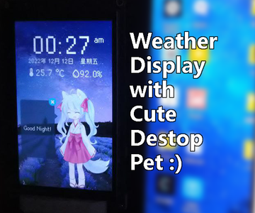

A few years ago, I got a concept of building a desktop weather display with clock and a desktop pet to make the display cute. I was inspired by the 20th year anniversary of a Japan software called "Sakura Script Player" or SSP for short, a tiny little desktop pet program that was commonly used in Japan around 2000.
The pet was a desktop software that run on Windows XP and can provide you time and weather information, as well as provide an interface for you to script your own functions. And I thought,
Wait, isn't this actually a weather display?
So I developed a project idea called the "ArOZ DSSP" back then but I never got my hand on building one. Until recently, when I moved out and start living by myself, I found out a weather / clock combo display will be really helpful. So I decided to build one base on my old project sketches.

The last step is to power it up. Plug in the micro USB cable into your Wemos D1 (ESP8266) micro USB port and your display should light up. After 3 seconds, the WiFi should be connected and time, weather information are starting to show up on screen.
Now you got yourself a cute little desktop pet weather display!
