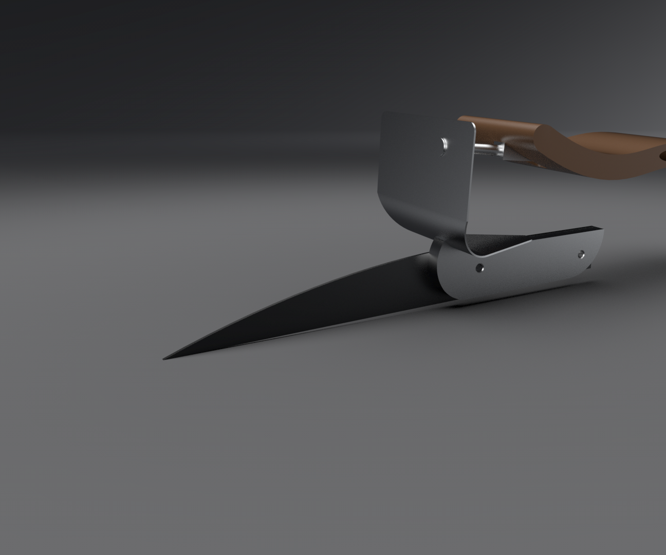

Introduction: Cutting Aid Advanced
The Cutting Aid is a tool designed for cutting without using the muscles in the hand/fingers. This product was originaly designed for someone who loves working in the kitchen but sufferes from a muscle limitation in the fingers. We have redesigned this original cutting aid to a more flexible setting, from wich anyone can make his/her own personal cutting aid (for your personal knife).

Step 1: Stripping Your Knife
First of all, you need to know wich knife you want to be used in the Cutting Aid. You can take a knife you love, or a blade you have laying around.
(You can also make the blade yourself if you want the Cutting Aid to have a more personal style or you can use another object to be put into the Cutting Aid, as long as it is similar to a knife blade)
Dismantle the knife carefully and make sure there are at least two holes in the handle of the blade. The holes must be at least 3mm in diameter because bolts and nuts smaller than 3mm are hard to find. If there are no holes in your knife, make two holes yourself!

To mount your knife to the lasercutted knifeholder-part, you can use standard bolts and nuts with a radius equal to the hole sizes of the knife. For instance: if your knife has holes of 5mm in diameter, you can use M5 bolts etc.
Warning: if your knife has holes smaller than 3mm in diameter, drill them out to 3mm. This is because bolts and nuts smaller than 3mm are hard to find.
To mount the knifeholder to the arm splint you must use two couples of an M5 bolt and a tee nut.

Step 8: Assembly
First hammer the M5 tee nuts in the arm splints holes. Protect the tee nuts with a piece of wood and anchor gently with a hammer.
Place the knifeholder into the arm splint and fasten using the 3D printed screw aids and the two pairs of M5 bolts and nuts.
Attach the knife to the knifeholder using the matching bolts and nuts.
Now use glue to attach the velcro to the arm splint. As soon as the glue is dry the cutting aid is ready.
Test the cutting aid!
