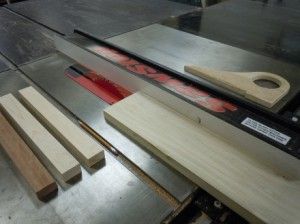

Step 2: Cut Wood Into 1/2" X 16" Strips
On the table saw, but strips of wood.

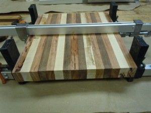

Step 3: Laminate Wood
In this step you will be laminating 20 of the strips together. Arrange the strips in a pattern of your choice. Apply wood glue on side surface, and clamp. Read instructions on wood glue bottle to see how long the glue needs to cure.
