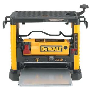

Step 6: Planing
Planing the cutting board is the easiest part of the whole process. A planer is a very useful tool to have around the shop. All I did was set the planer to shave off about 1/64 inch and made many passes until the it was all the same height
