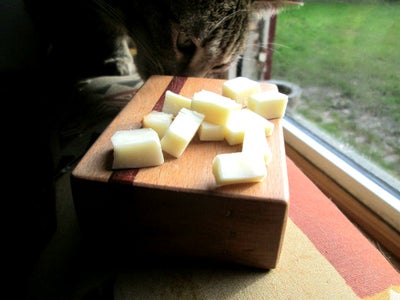

I wanted to materialize that moment - we're humans after all and before all I'm a maker. Almost instantly I thought about cutting boards. To me, cutting boards are synonymous for good time - unless you use them to cut your fingers or smash mosquitos. Cutting boards trigger quality time. Some sliced cheese, a good beer - you know that feeling.

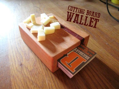

I can't carry a large cutting board with me all the time, but I do can carry a small one. Pocket sized.
'Why not just make a wooden wallet cutting board?!' I thought.
Marriages are compromises. Also this one. It had to be a container able to contain my stuff firmly, and I wanted that it would release its content with only one finger-clip. Just like a pocket knife. Grip 'n slide. And it had to be cutting board like. And it had to be something that everyone could make. This is instructables after all. Not everyone is supposed to have a thousands of euros worth CNC router, laser cutter or 3D printer. Basic tools, basic supplies. Power to the craftsmen.
That made quite a lot of parameters in one eaquation, and so I started drawing. The outcome became the one and only wallet you'd take out of your pocket with a smile.

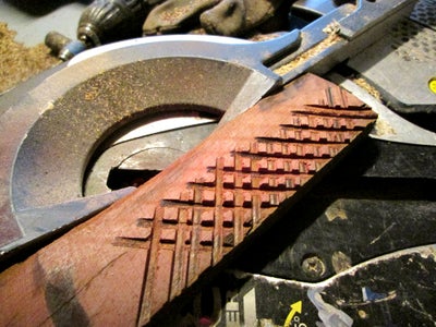

You'll make a kind of 'clip'. This will hold all our cards & notes nicely together and move with a little help of your fingers inside its wooden coffin. Like a money clip, but way better.
Keep it simple: grap a piece of alu & bend it like beckham. Height: same as the inside width of the wallet (see next step). Length: same as a plastic card.
Then you'll search for a small piece of hardwood and glue it to the clip. CA, bicomp, HT3000 or whatever you might have hanging around. Avoid milk or rice water. Roughen the glue sides, let it harden overnight and sand the edges.
To give it a better grip you can add a fish, beaver, crocodile, T-rex or cow-tongue pattern. Functional and awesome.

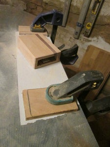

All you need is glue, clamps & patience.
Don't forget to insert the clip BEFORE you glue the second cover. Just in case...
