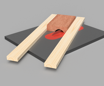

Cove cutting on a table saw is a common practice to make rounded grooves and mouldings.
You slide the workpiece across the table saw blade at a skewed fence angle, and you end up with a nice concave groove. When you tilt the blade you get even more interesting asymmetric profiles. But how do you predict what the cut profile will look like? Well, I share a parametric Fusion 360 file where you can change the fence angle (skew), blade tilt, and blade height; and see the resulting cove profile before cutting any real wood. If you use Fusion 360 this model is really easy to use.

Download and open the attached Fusion 360 file “Cove Cuts.f3d”. In the design space you will see an 8” by 12” by 3.5” thick workpiece. This is for modeling purposes only to show the cove profile; in real life you will probably use a different size piece.
The saw blade is assumed to be standard 10 inch diameter, 1/8” kerf.
