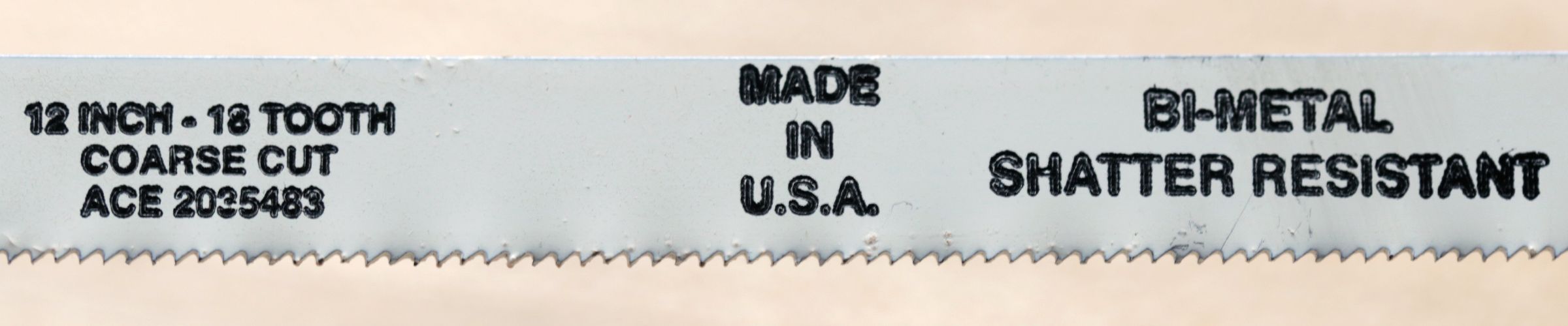

Blades consist of a continuous series of cutting points angled in the cutting direction of the blade. The hacksaw we will be using in this class uses a blade to cut. In fact, cutting blades are common of most if not all the metal saws you will encounter in the workshop. These saws tend to differ from wood saws primarily in speed and the size of the teeth on the blade. Metal saw blades have teeth which are smaller and closer together. Course blades such as the one picture are good for harder metals like steel. Finer blades are better for softer metals.

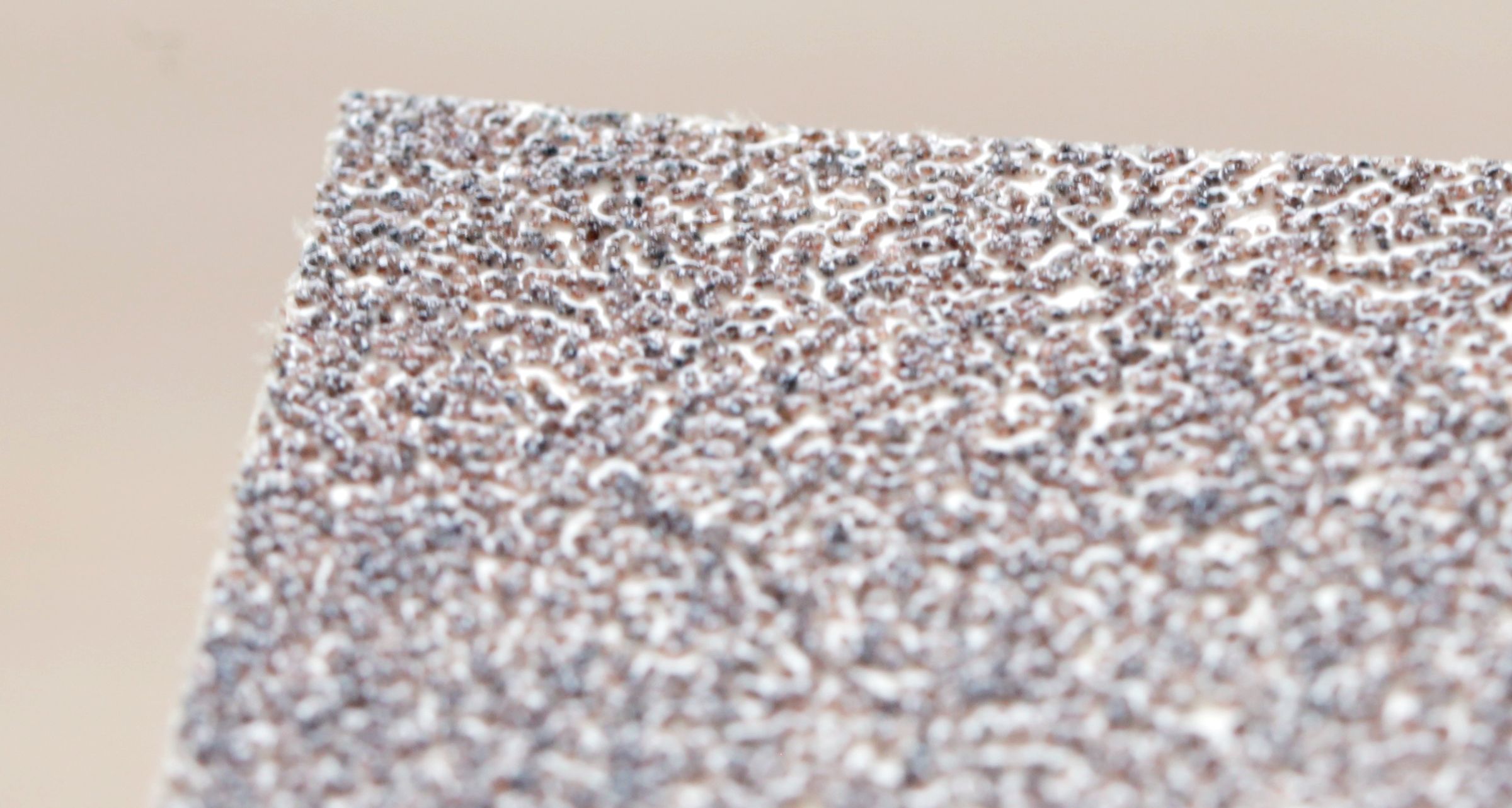

Another way to cut metal is by abrasion, which is just a fancy way of saying sanding or grinding. Contrary to popular belief, abrasion works the same way as blades do. Each little piece of grit is actually a single cutting point, and each one removes a little bit of metal. This is largely meant to shape the surface of a piece of metal. In this way, abrasion tools are more similar to files than saws.

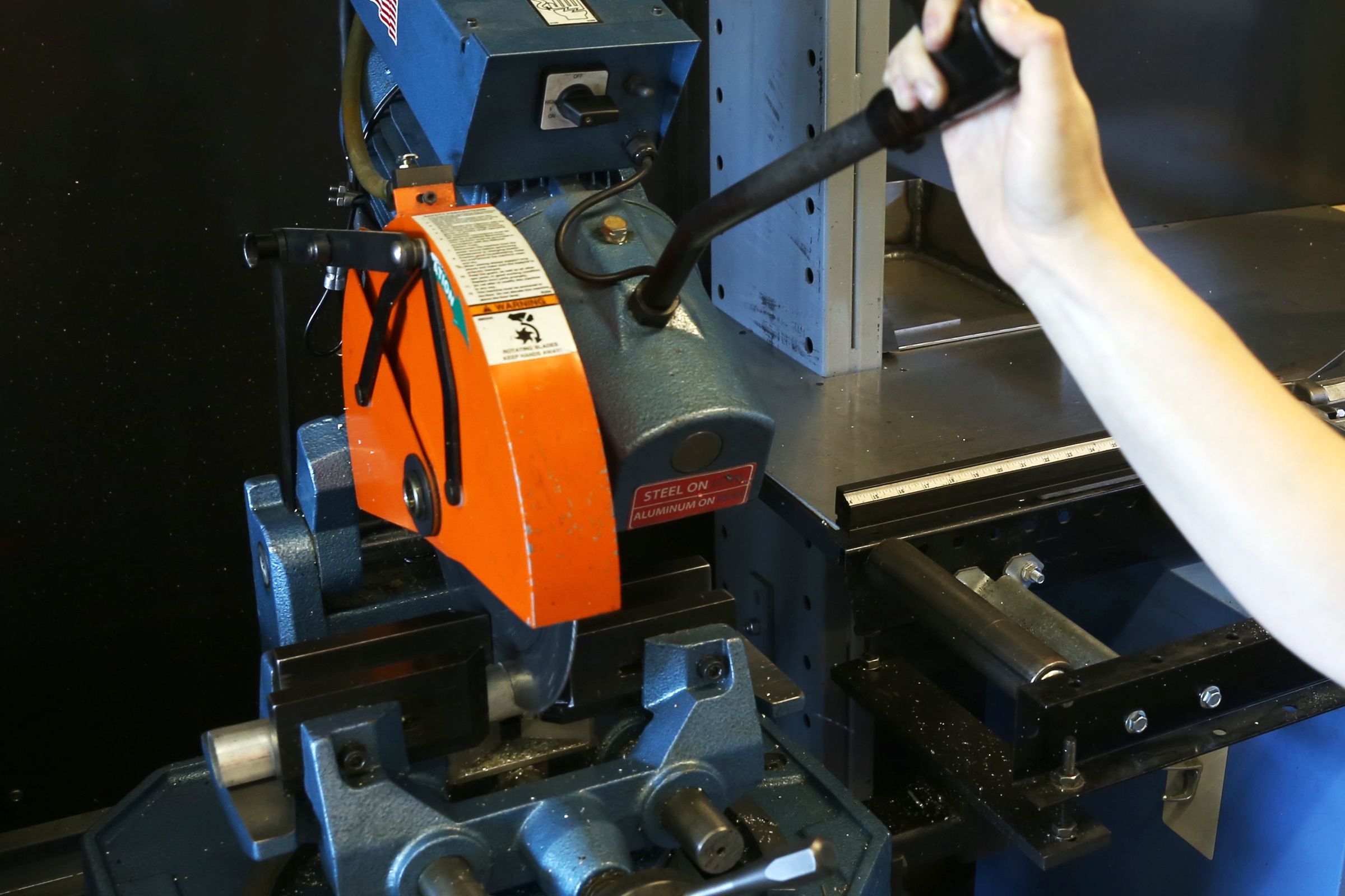

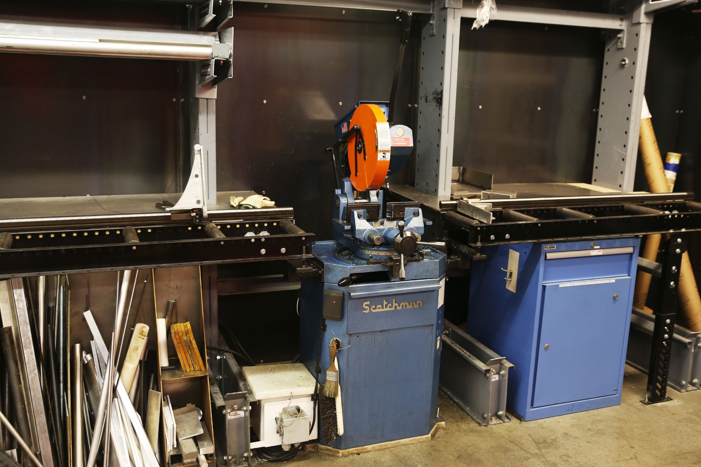

A cold saw is a circular saw that is commonly used for cutting tubing and metal bar stock. It has a round toothed blade which transfers heat away from the part being cut, to the chips. Hence, the name cold saw.

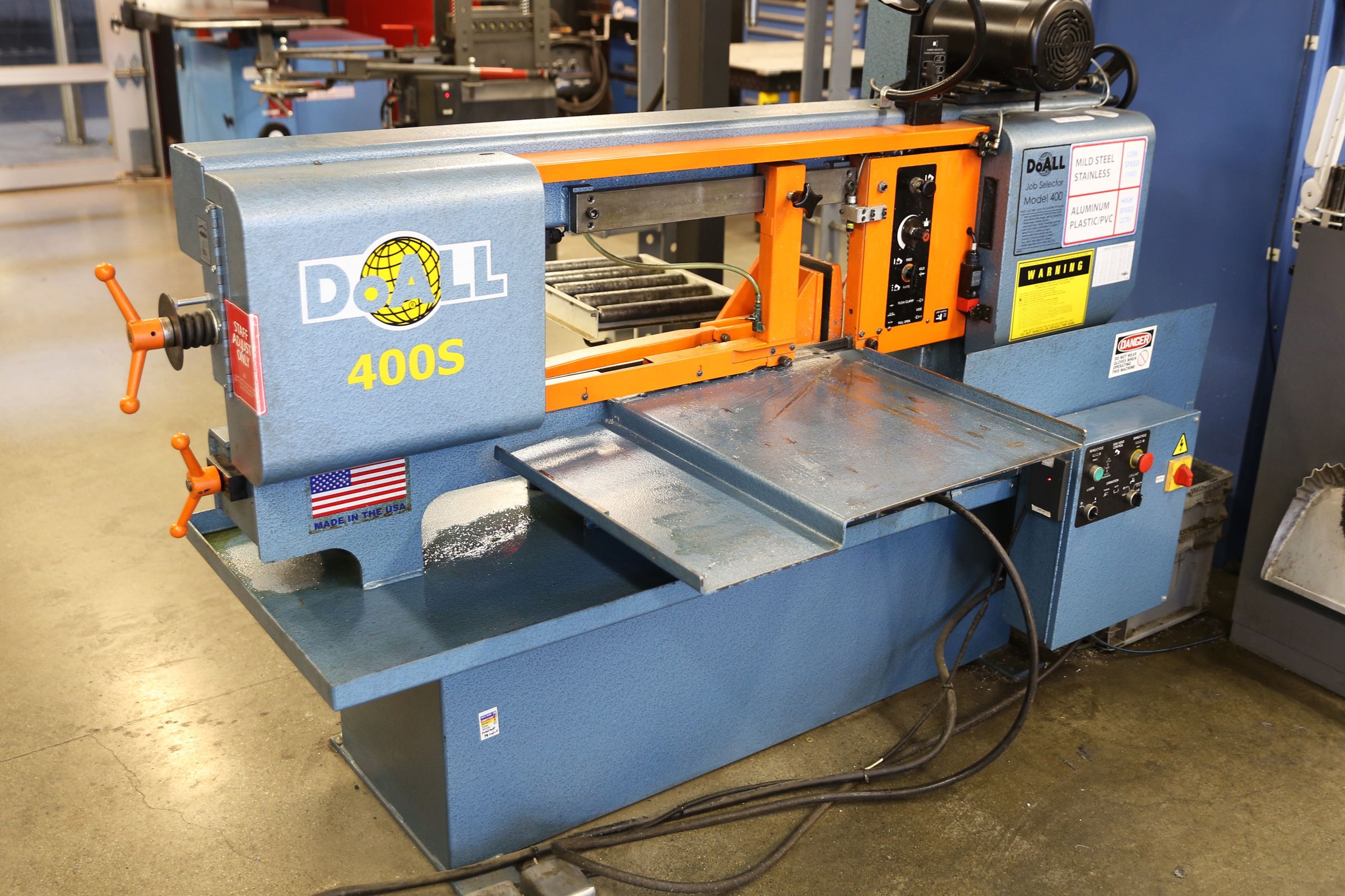

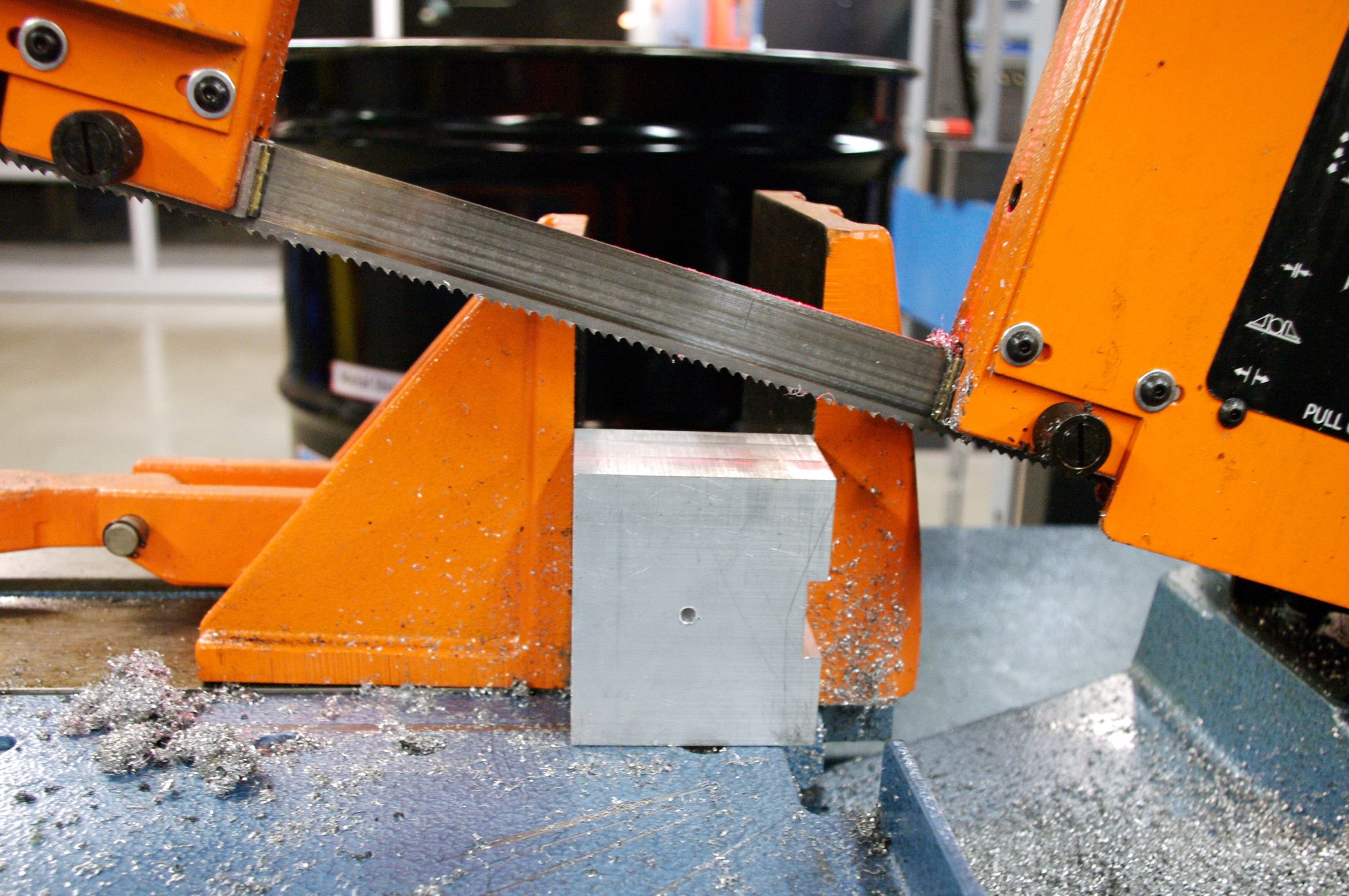

A horizontal band saw is basically just a band saw turned on its side. Rather than moving the part into the blade by hand, the entire blade is automatically moved down into the part. This makes the saw great for making straight cuts down into metal stock, and it can handle some smaller sheet metal and generally larger pieces than you would want to cut with a cold saw. Some horizontal band saws can even make miter (angled) cuts.

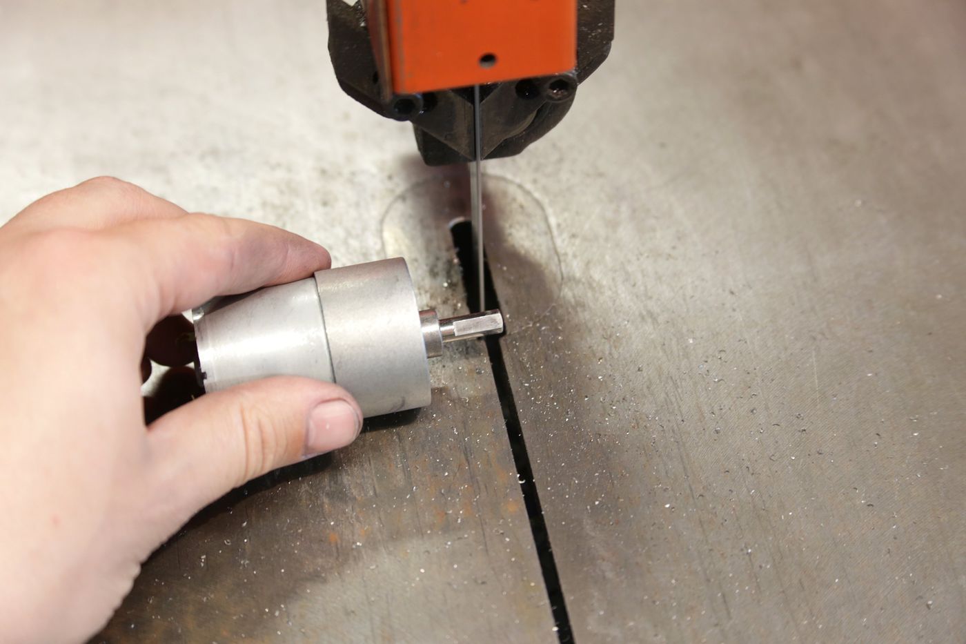

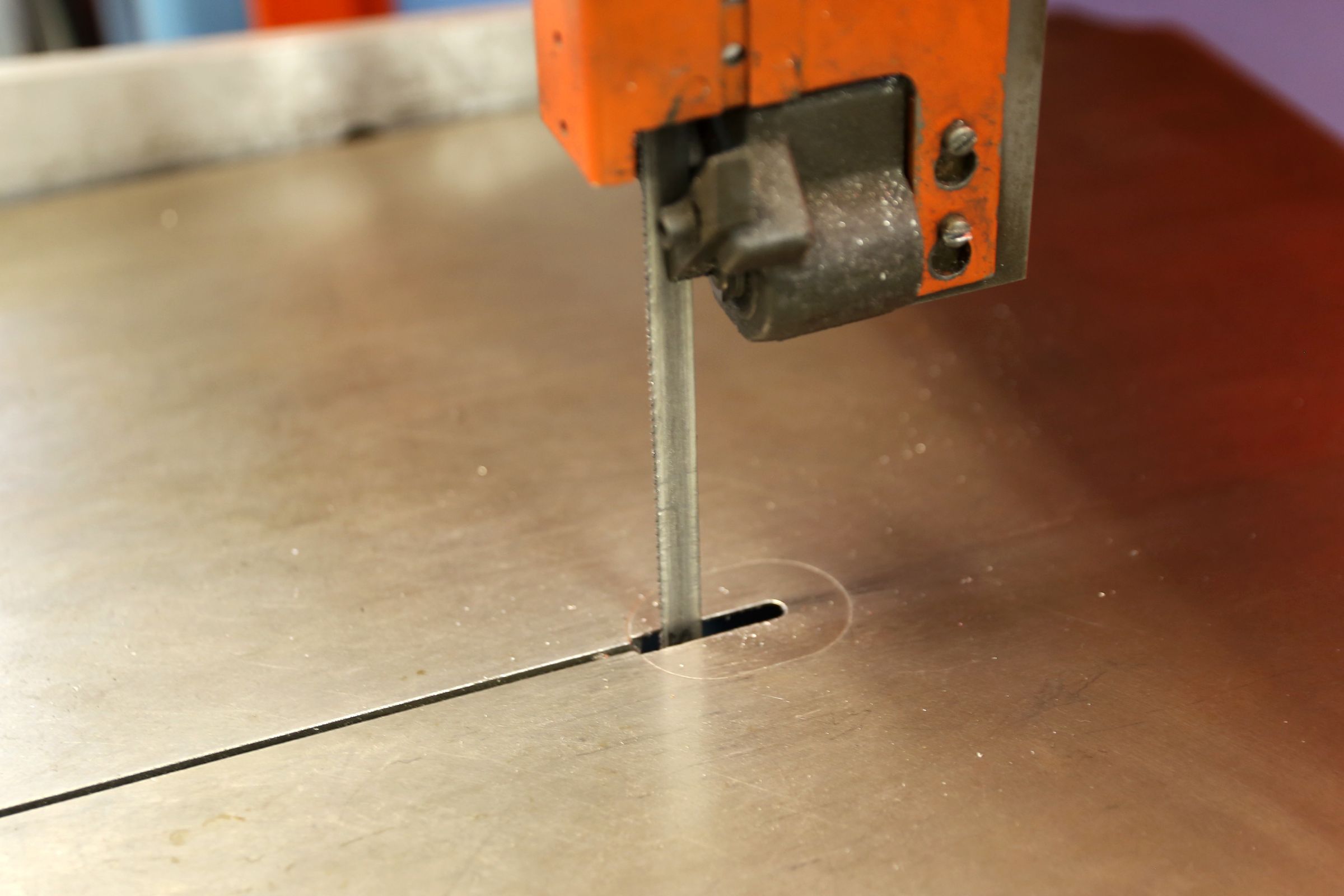

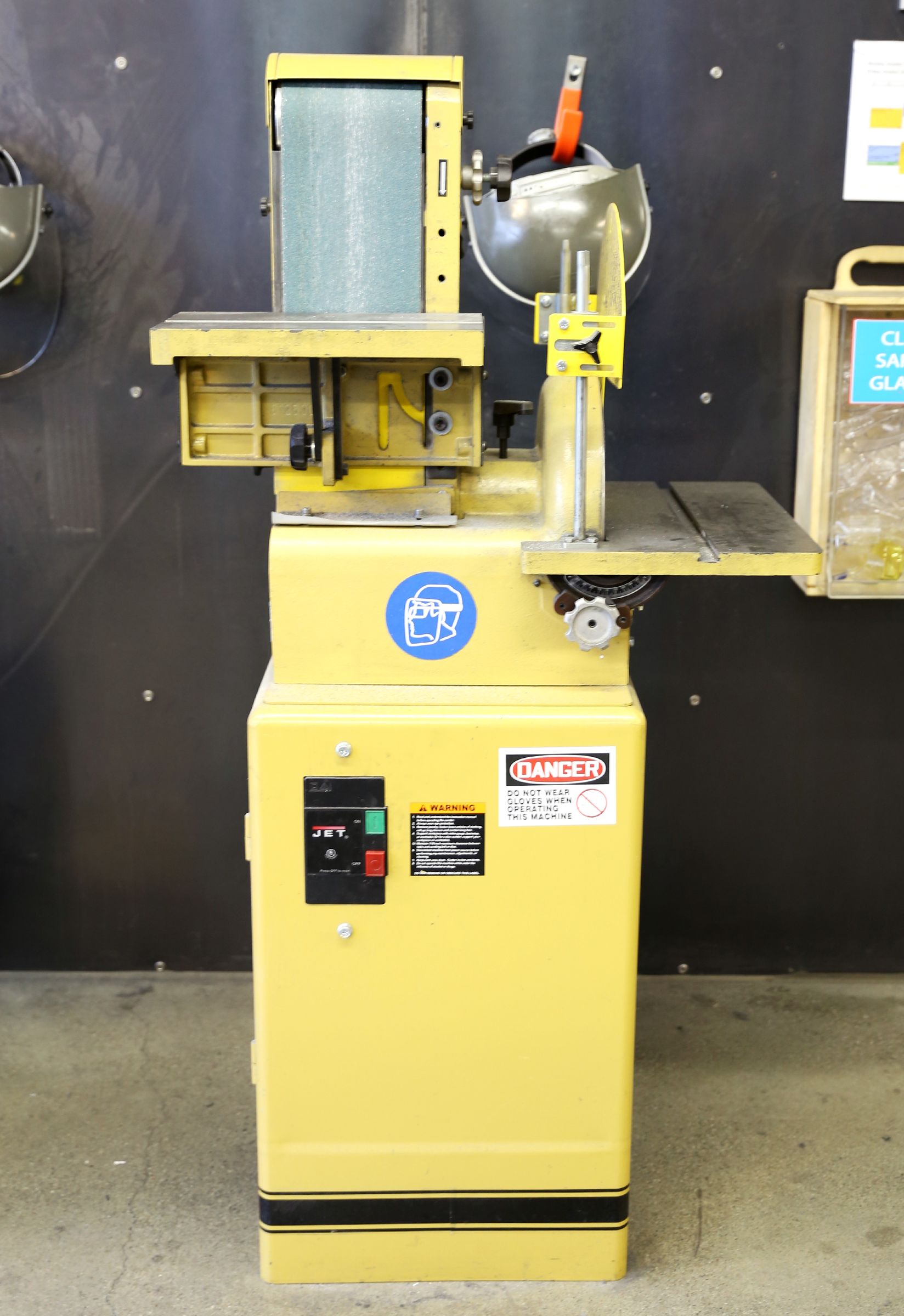

A belt sander consists of a continuous loop of sandpaper traveling around two pulleys. In a way, it is like a band saw, except instead of a blade, it uses an abrasive sanding sheet. The exposed portion of the sandpaper sheet travels across a flat steel surface. By pressing a part against this surface, you can quickly remove large parts off the surface of a piece of metal and/or conform it to a shape.

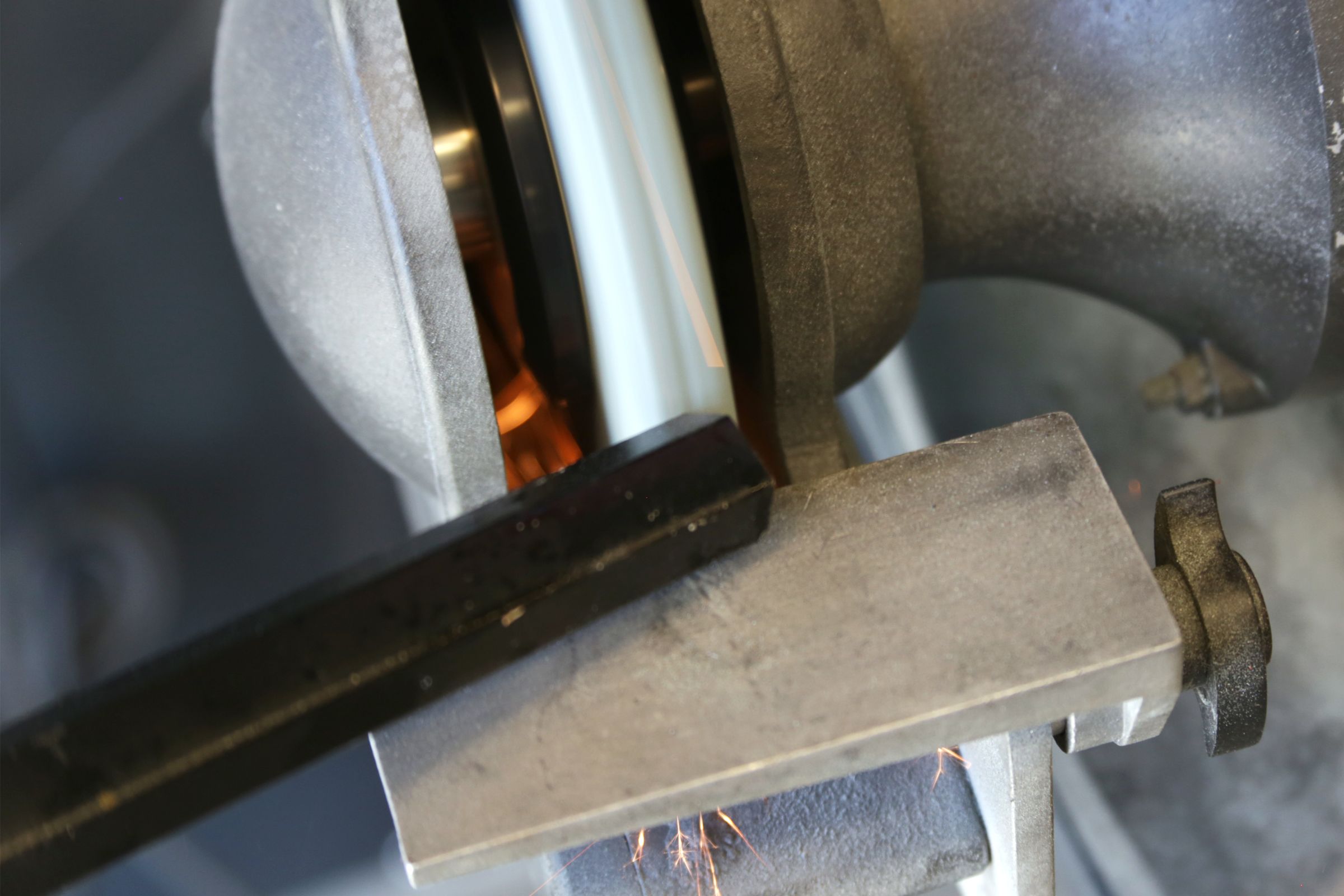

Grinding wheels function much in the same way as belt sanders, but are meant for harder metals like steel, stainless steel, and all other hardened varieties of steel. This wheel is typically used for grinding away corners and sharp edges.

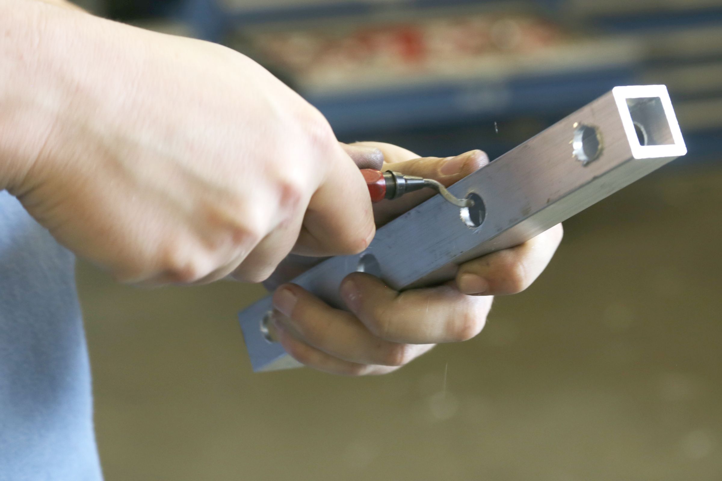

Step 6: Deburring
When you cut a piece of metal, you are invariably going to leave behind burrs. A burr is a sharp uneven raised edge caused by the cutting blade passing through the piece of metal. As it cuts, it pushes out the then layer of metal that is left around the edges. Imagine the blade cuts a sheet of metal to the thinness of tin foil and as it nears the edge, rather than cutting away this material, it just pushes through and breaks it. That flake is essentially a burr.

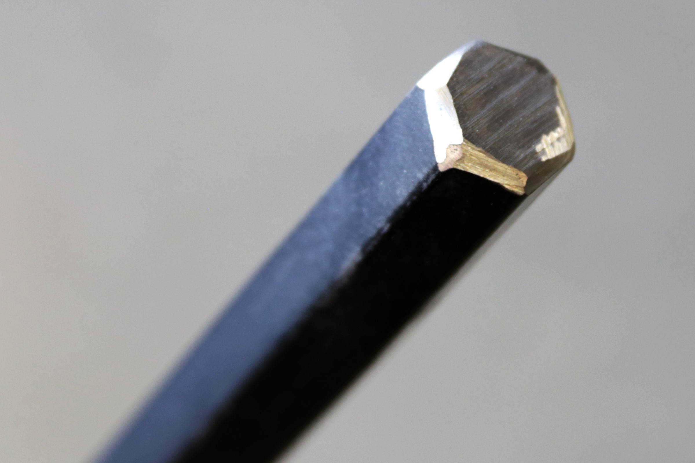

Burrs tend to be sharp and unwanted and thus must be removed. One way to remove them is to use a deburring tool. This typically consists of a handle with a curved and hardened steel blade that is
dragged across the edge being deburred to cut it away.
Another way to remove them is with a hand file. Using the file you can lightly file the burrs away until the edges are smooth.

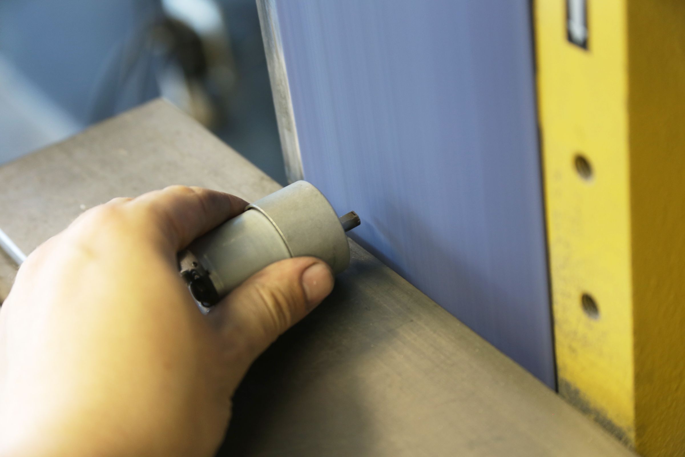

Step 12: Clean the Edges
To deburr the inner edge we will use a deburring tool. This tool works really well on inner convex edges. Simply drag it around the inside of the circle and see how it easily peels the burr away.
Step 13: Check for Accuracy
If you place your cut edge on a flat surface you may notice it is slightly uneven, and the pipe is leaning to one side or another.

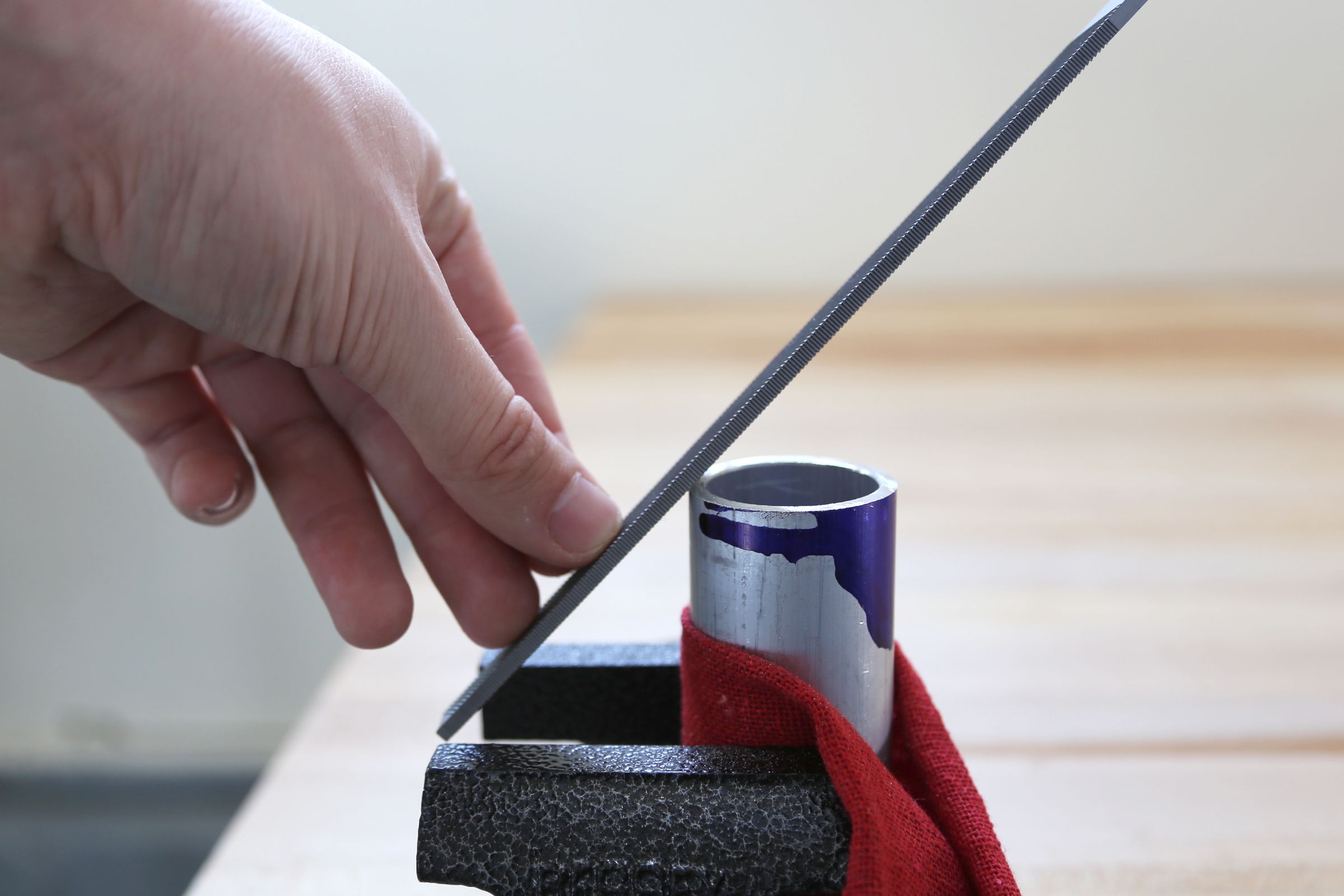

Step 14: Level It Off
To fix this, we can use a file to level off our cut and also deburr the outer edge.
To begin, file the top surface of the pipe until it is approximately flat. Hold the file's handle by one end, and press down on the other edge firmly to level off the surface.
Remember that the file is essentially like a saw blade and always cuts in one direction. When the file is pushed away from your body it will cut.
To deburr the outer edge, cut downward at about a 45 degree angle and gently apply a light pressure on the end of the file with your fingertips.
Step 15: Done!
Once the edge is leveled, the tube should sit squarely on the table and not be leaning to any one side (or, at least not as much).
