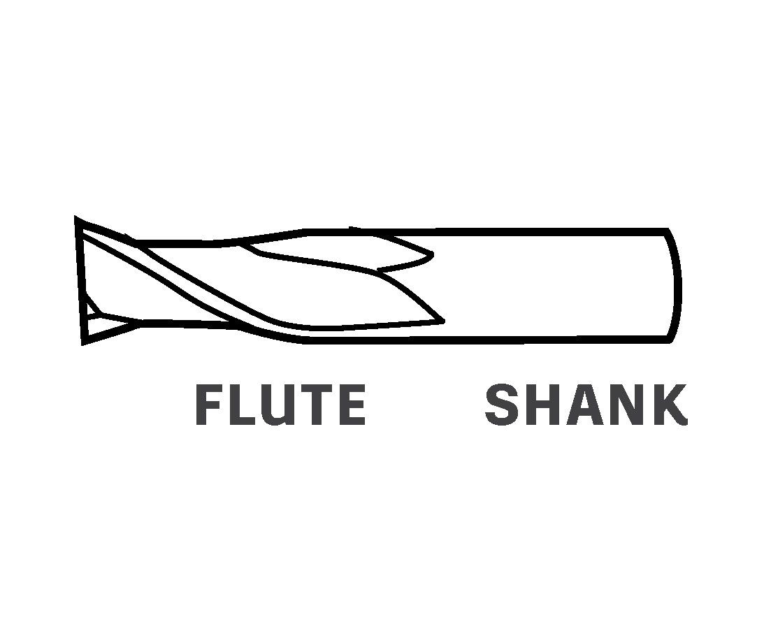

Cutting tools have two parts, the shank and flute.
The flutes are the cutting edges of the bit. The shank is the section that goes into the tool holder.
The shank must always be the same diameter as the tool holder. The flutes may (or may not) be the same diameter as the shank.

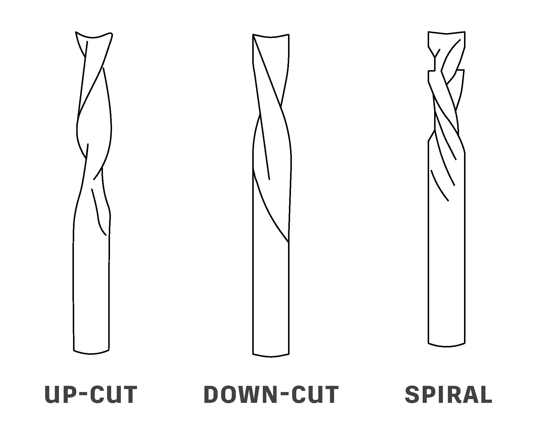

Some bits are available as up-cut, down-cut or compression spiral.
- Up-cut
- Sawdust is ejected from the top of the workpiece.
- They damage the top layer of material.
- They tend to lift the workpiece off the table. Be careful with workholding.
- Down-cut
- Sawdust is pushed into the workpiece.
- They push the workpiece down onto the table.
- Compression spiral
- A combination bit (down-cut on top & up-cut on the bottom) designed to cut all the way through sheetgoods in a single pass.
