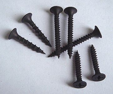

Step 1: Holding Down the Materials to Be Cut
It is very important that nothing moves or slips while you are cutting things on the Shopbot. Holding down the materials is an important thing to think about when you are making toolpaths. You need to be careful that you do not cut into what ever is holding down your material and that you don't cut your piece of material out of what is holding it before you are ready. I usually use screws to hold things down. They are easier to use than clamps and usually work just fine. Clamps have a tendency to slip and are more bulky. If you are using clamps, be sure that the safe Z height for your tool is set so that the bit will be kept well clear of the top of the clamps when it is moving from place to place.

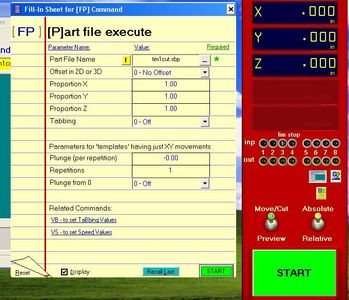

Hit load file in the bottom left corner. Browse for the file. After you have selected it a window will pop up asking about more options. You usually won't need any of these. After you have made sure everything is ready and turned on the router, press start. If there are any problems while you are cutting, hit any key, the mouse, or one of the stop buttons.
