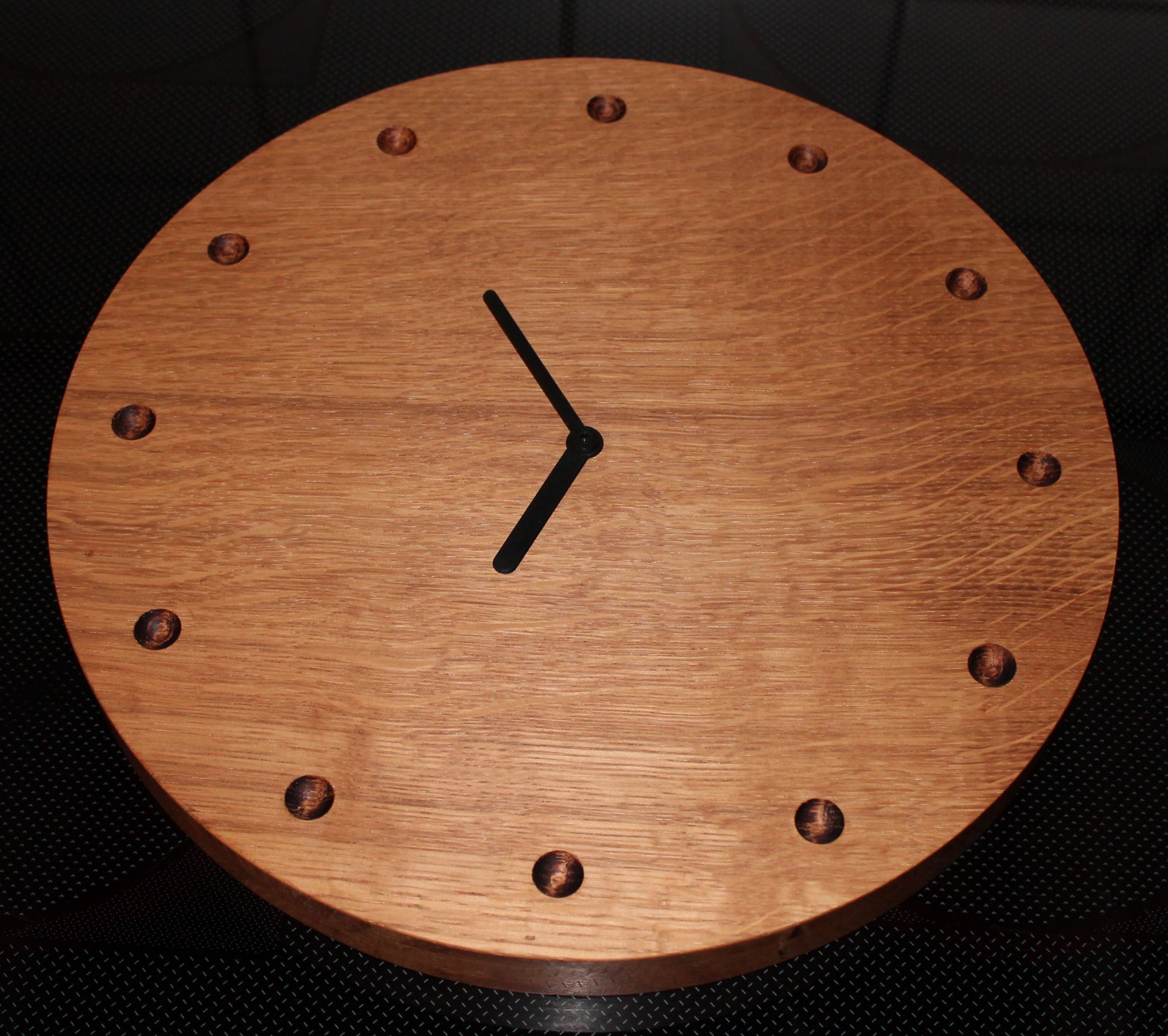

I have made two, one with the wood from the tread of an old oak staircase, the same as I used for this clock, and another from a desk I found on the curb. I don't know which wood was used for the desk, except that it's hard.
