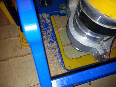

- Place the blue pointer into the base plate.
- Important edit: make sure the pointer is all the way down in the base and check between tiles because if the pointer works it's way up it will interfere with the Y axis!
- Set the bot onto your work.
- Pull it up to the first notch of the jig stick.
- You want to pull it up firm and make sure the pointer is bottomed in the notch, the base plate should have good contact all the way across the stick.
- Double check alignment with the cursors that are built into the base plate, for the first tile they should be aligned with the corner of your work piece.
- Run your file
- Move to next notch
- if there are any chips in the way blow, vacuum or brush them away, it just takes a little to start throwing your work off kilter.
- Continue across panel
- After going across panel come back to notch 1 and add the 8 inch spacer.
- After that row, remove the 8 inch spacer and install the 16 inch.
- If you need another row, add the 8 inch spacer back in and do the next row
There is enough 16 inch spacers to go all the way across a full plywood panel but as we talked about in the planing stage, I don't think it is a good idea, if 32 inches of Y travel is not enough you might want to revisit your design.
