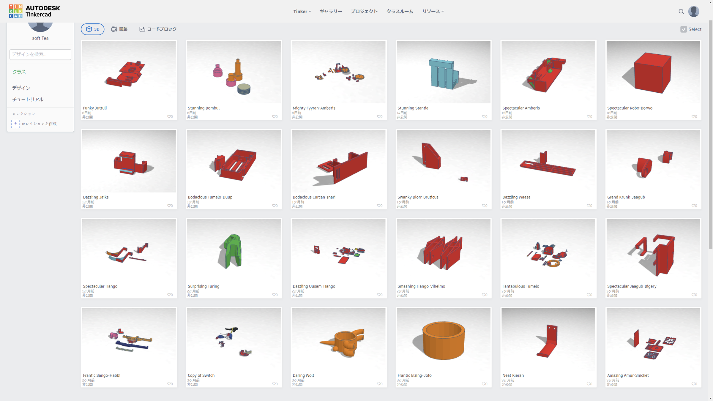

Step 6: Handle (direction Switch)
Create with a 3D printer. The design was unexpectedly difficult, and I made a prototype five or six times.
By the way, I use [Tinkercad](https://www.tinkercad.com/), which is easy to handle even for beginners.
If you want the STL model, please comment and I will upload it
