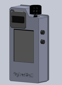

Step 1: Designed
As a child, I dreamed of owning a Walkman, an expensive gadget at the time, but it was out of reach. Fast forward to the present, technology has enabled us to create such devices ourselves. This inspired me to design this unique Music Player to share with others who enjoy similar concepts. I also infused my favorite Cyberpunk aesthetic into this project to reflect my passion.

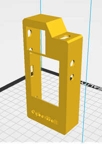

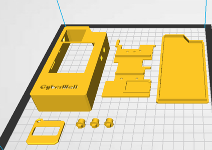

Step 3: 3D Printing

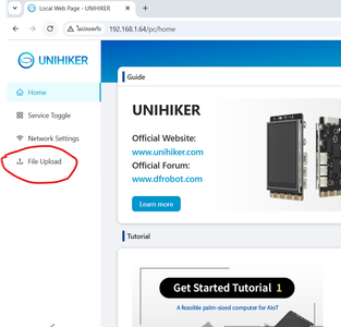

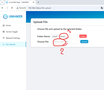

Step 7: How to Upload MP3
