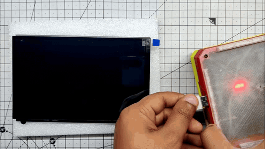

Step 5: Display Power Source Edit
This device is powered by a 5V Mini USB Port, which is great if we're using it as an external monitor. However, since we're building a mini computer, using an USB cable to power the display will take up too much room on the rear.
The goal is to shorten a USB cable to an extremely small size, attach its positive and negative wires directly to the display's input side, and then use that cable to power the entire display.
The display's rear cover must first be removed in order to reveal the circuitry. We add the USB's positive to AMS1117's input terminal using a soldering iron, and the negative of the USB will get connected to the GND pin of AMS1117. There is an AMS1117 voltage regulator linked to the USB that steps down from 5V to 3.3V for the display to work.
The display turns on when the USB 5V is supplied through a 5V power source, indicating that this small hack was successful, and we can move on to the next step, which is to assemble the frame.

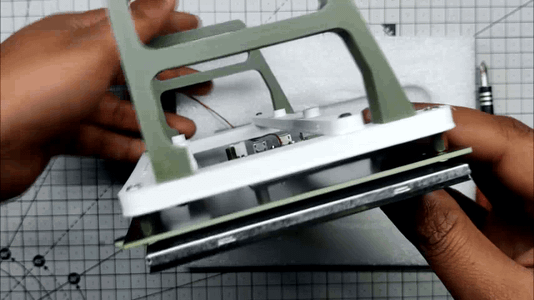

Step 6: Frame Assembly 01
  • Using two M2 screws, we first assemble the frame by joining the component that holds the raspberry to the main structure.
  • The left and right stands are then attached to the frame using two M2 screws on each side.
We now have a 3D-printed frame that will hold both the Pi and the display.
Step 7: Connecting the Display to the Frame Assembly
The four PCB standoffs on the display are now used to join the frame assembly to the rear of the display. M3 bolts are then used to fasten the frame assembly and display together.
Step 8: Adding Pi
The Pi can now be placed on the back side of the frame assembly and attached using four M2 screws since the frame assembly is installed on the rear side of the display.
