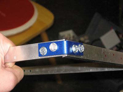

Step 17: Board Creation, Ahoy!
Finally, it is time to construct the board! Huzzah!
I epoxied the blue squares onto a 10"x10" sheet o' metal that I'd spray-painted silver, and let that sit for about 8 hours or so. Once it was done, I unwrapped the plexiglass cover and put that on top, then screwed on the angle brackets.
After that, I put the corner braces on the frame, followed by the flat braces. The results can be seen below.
